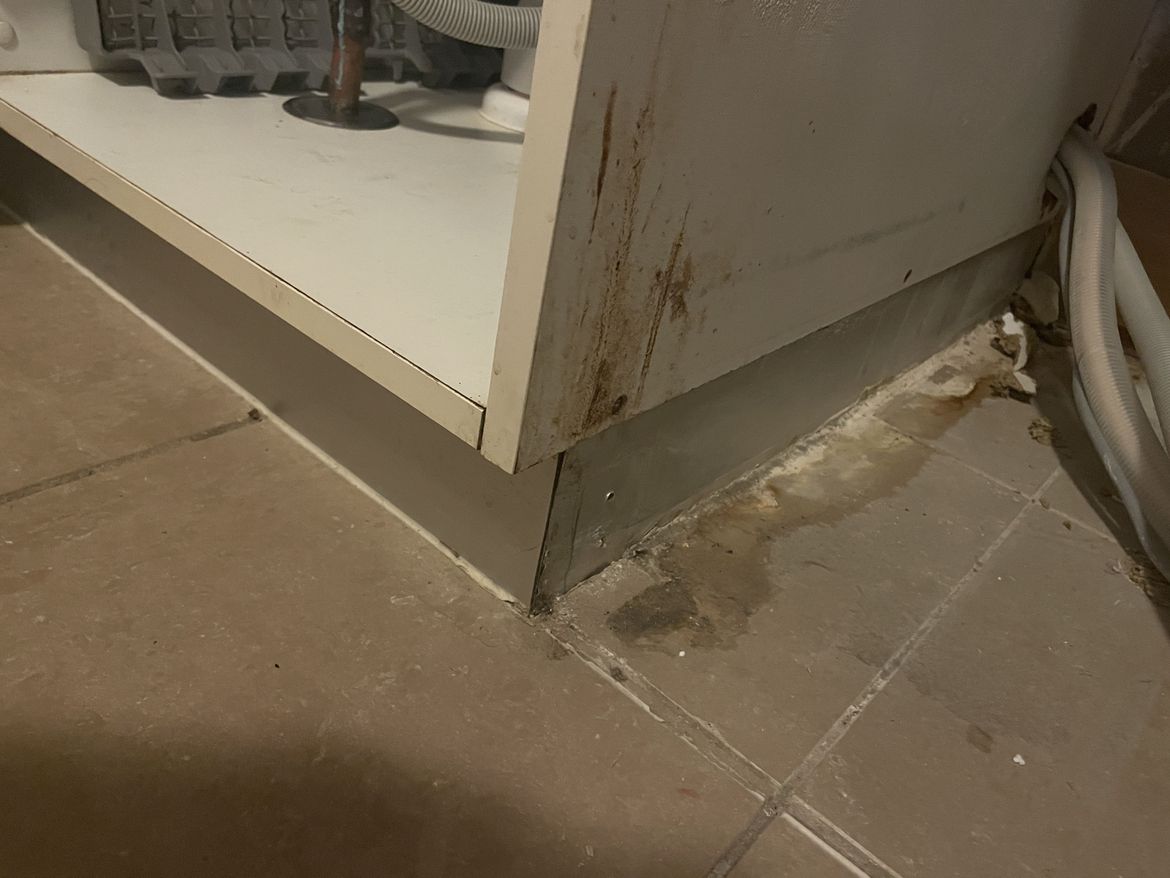

I want to replace a kitchen kickboard due to water damage. From what I understand it seems fairly straightforward - the board next to the damaged one is under the dishwasher and was glued in place and came away when I pulled it, but I'm not sure the one I want to remove is the same as most others - it is joined at the corner somehow to another board, which seems fairly fixed in place, rather than being able to just pull it away, and I'm not sure how to remove it. There are no screws inside the bottom of cupboards down into the boards.
It is also glued along the bottom with some kind of caulking/sealant - I assume I can just chip this away.
See photo for details - any questions let me know. Any advice would be much appreciated!

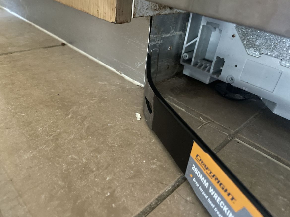

I've been using the Craftwright wrecking bar and trying to lift out the corner of the kickboard, but no matter how hard I try I cannot get it to budge. I've uploaded a picture just to show where I'm putting it. There are no screws inside the cupboard down into the kickboard that would be holding it in place. Any suggestions?

Are you able to pull the dishwasher out to see how far back this sideboard extends? Typically, kickboards are installed last and clipped onto the cabinet legs. In your case, the kickboard could have been attached to the cabinetry before installation. It might be affixed with angle brackets from behind. If this is the case, simply trying to remove it from the front might not be possible. If it was loosely attached, I'm fairly certain you would have been able to remove it with ease.
Touching on your original reason for removing the board, to replace a water-damaged section, do you actually need to do this? If the water leak has been resolved and the timber is still structurally sound and dry, then there might not be a need to replace it.

Re: the reason for removing the kickboard - I can live with it as it is, but a water leak I had has caused bubbles to form and it just doesn't look very nice. I've attached a photo to show you.

Ok, I finally got my dishwasher out - there were screws inside the dishwasher that went out and into the cabinet alongside (not very practical - I'm going to have to make sure the dishwasher is in exactly the same position to screw them back again!)
I've attached a picture - the kickboards go all the way to the back of the cupboard. It sort of seems like they are an integral part of the cabinets - what do you think?

There is a good possibility that the panels are an integral part of the cabinetry. It could have been constructed with the kickboards being the base of the cabinet instead of them being removable panels and having a leg systems behind them.
