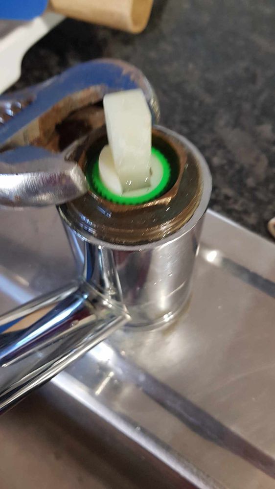

My next drama is i'm turning the the giant nut, but the whole outside silver bit is turning with it, i'm presuming i should somehow clamp the outside bit.362628908_117263224770258_151344790036205888_n.jpg
Re: Shaw and Mason hitchen mixer tap leak.
Is the outside silver bit connected to the spout, and as the spout turning as well, @joefire? If so, grip the spout with your other hand and keep it stationary whilst you undo the nut or place something in the sink that inhibits the spout from turning. If this is an independent sleeve above the spout then you'd likely need to grip it with something, and a pipe strap wrench is likely the best tool in order not to cause damage to the chrome plating.
Yes, definitely seperate as the spout bit moves and the top sleeve stays put generally. Yep, been trying to grab it with a tupperware can opener, but it aint grippy enough. To my shed to see what i have, but i definitely don't have a pipe strap wrench.
Thanks again.
If you use any tool with teeth, make sure to wrap a dozen or so revolutions of tape around the sleeve and use a cloth to protect the chrome plating.
