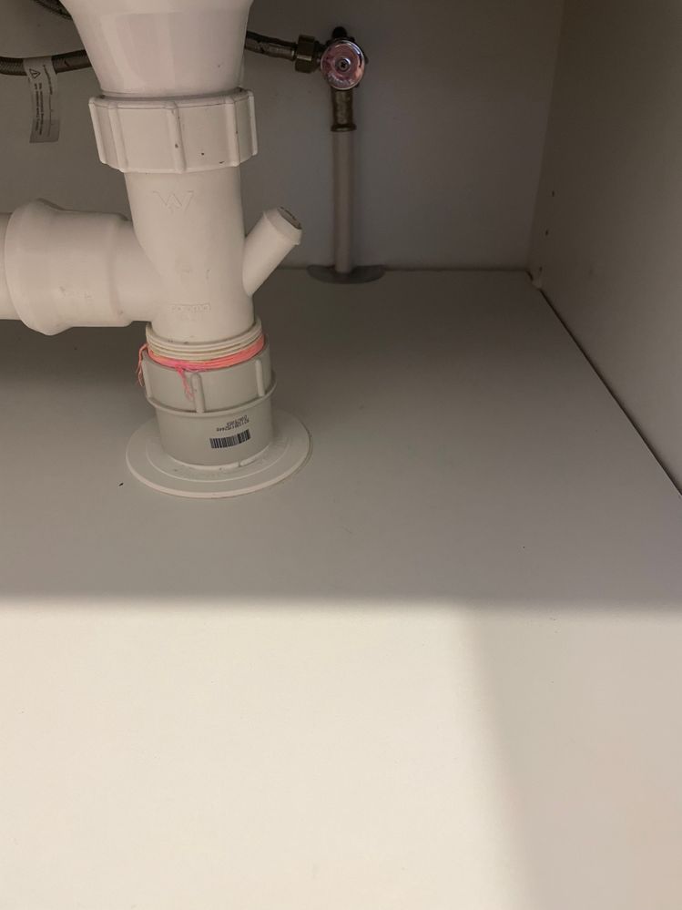

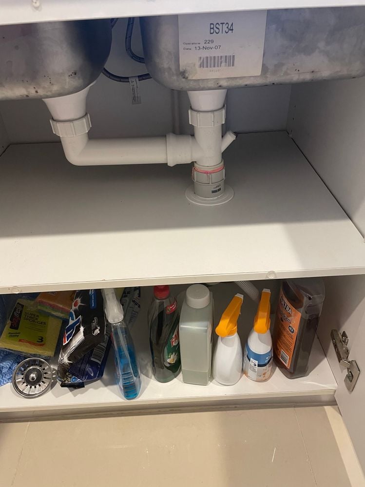

I want to raise the height of my under-sink shelf. It needs to come up by 40mm,
The question is, how do I raise the thing around that sink drainage pipe?
I was hoping I could just slide the shelf up.
The grey section just above the shelf (with the pink tape on top) seems to be attached to the shelf via the white seal ring. Would that be a normal thing to do during installation and can I just attempt to peel off / cut the white seal ring?
I don't want to risk breaking the pipes - any advice appreciated.
Thanks!
Re: Raising an under-sink shelf around pipes
Hello @VincentK
In this instance the plumber has done his job very well and even sealed the pipe cut out in the shelf. It appears that there is enough space for the shelf to move up to the next position as indicated by the holes in the shelf wall. You should technically be able to remove the shelf flange and move the shelf up.
But if the cut out is too small, it will be necessary to disassemble part of the wastepipe so that you can slide the shelf out and cut a larger hole. Once you've cut the bigger hole, I suggest testing its new position by moving the shelf supports up to the next level. Worst case scenario is that you'll need to cut a larger hole to accommodate the wastepipe assembly as it will hit the shelf.

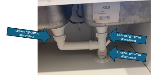

Good Evening @VincentK
I really cant add more to what @EricL has suggested They are the steps I would be suggesting as well. Just have some low edged buckets and old towels about when you disconnect the pipes is the only thing I can add. The water in the bend may be a little stinky, probarly wont be needed as it looks slopped but better to be safe

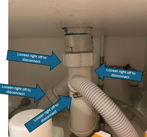

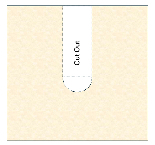

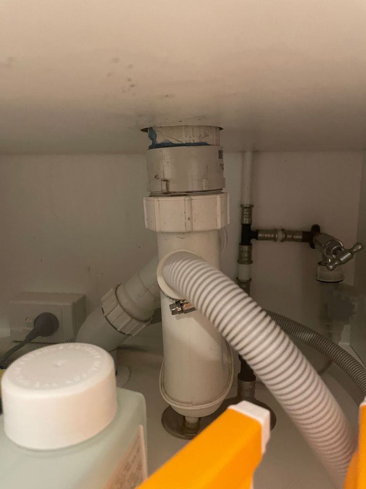

You will need to disconnect all the pipes and tubing. Then slide the shelf out and reposition the shelf supports up as required. Then measure and mark a cut out from the rear of the shelf forward. Use a circular saw for the straight cuts and a jig saw with a "scrolling blade to make the curved one. Alternatively a jigsaw for both cuts. But use a standard blade for the straight cuts. Make the cuts with the board upside down as this will result in any splintering of the cut edge on the underside unseen. This will now allow you to slide the shelf back in. Reconnect the pipes and check for leaks.
