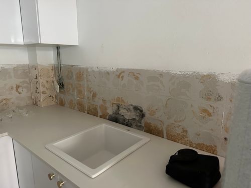

I am wanting to tile my splashback myself after reading the ‘how to’ on here. I am just wondering if anyone can offer up some advice on how to get about this hole above my sink? It was where the old plumbing was taken out and moved.

I propose using Dingo 10kg Mortar Mix to patch the damage on your wall. Make sure to cover your benchtop with cardboard or painter's heavy duty dropsheet to make sure it does not get splattered with wet mortar. Keep the cover sheet on until you've finished the entire tiling project.
Please make sure to wear personal protection such as gloves, goggles and a mask when working on your project.
