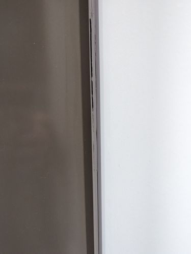

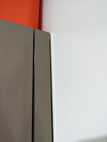

Hello There,
I got some great advice from @EricL about another matter recently so I thought I'd shoot through another question.
I have noticed my tall pantry cabinet is gapping between the wall and the cabinet. There doesn't appear to be any changes with the other cabinets and I'm not sure if it's just the silicone/gapping coming off from between the wall and cabinet. It is also happening to my tall cabinets in my bathrooms as well. Is this just a cosmetic issue that can be fixed by DIY?

Re: Gap appearing between cabinet and wall
Hello @dormane
Thanks for sharing your question about the gap near your cabinet and wall.
It's possible that there has been movement in your internal wall which has caused the gap to appear. Or as you surmised the silicone has given way. The good news is that it can be replaced. I propose using a Monarch Caulk & Sealant Remover, this tool should be sharp enough to pick up the old silicone and allow you to clean up the gap.
I recommend using Selleys 475g No More Gaps Interior Multipurpose Gap Filler or similar to fill up the gap. The water-based formulation has been designed to cope with building movement to ensure a long lasting and crack resistant finish.
Here is a handy step-by-step guide: How to silicone seal a bath (the techniques used area applicable to your repair project)
