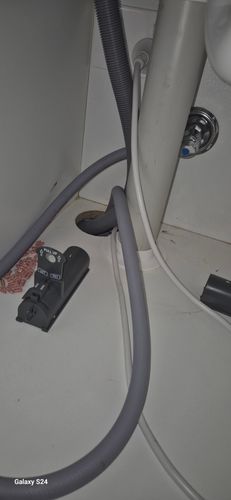

How to fix a hole under kitchen sink?
majidrizwan
I wants to close a hole by cardboard under kitchen sink
because it is pathway of roddent. Thanks.

Take a net and cut small opening for the pipes and nail them in with a small mdf piece as a washer for the nails

As @J-P mentioned, you'd need to use something more solid than cardboard, as a rodent chew through it easily. You could take some chicken wire, scrunch it up, and then push it into the hole, but not entirely through it. You could then cut some cardboard to neatly fit around the exposed area to cover the wire. Alternatively, you could cut one of these Kinetic 50mm White Oval Adhesive Cover Plates to fit around the pipes and cover the hole.

You could put steel wool in there. A few drops of peppermint will also deter them. Not essence.
