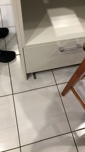

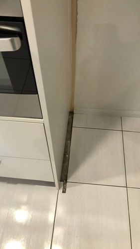

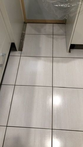

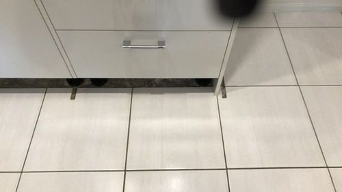

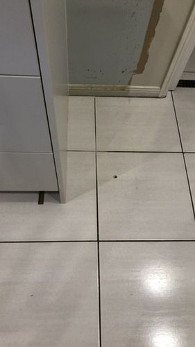

Hi all,
I'm looking for advise as to what to do with these tiles which need fixing. I only have 7 tiles spare. As much as I would love new flooring is not going to happen anytime soon. The kickboards can't be done until I find a way to patch them. Depending on what's suggested as to if my partner and I could DIY it. I've got my doubts about abilities as we both have health issues that tend to get in the way. Thank you in advance.

Looking at the pictures you posted, I don't think seven tiles will be enough to cover the remaining gaps in your kitchen. However, I suggest trying to find the closest compatible tile in colour and size. Because it is located at the bottom of your kitchen cabinets, it will not be the first thing people see in a kitchen. Below are my suggested steps:
- Count the number of tiles you will need to finish your floor minus the seven that you already have. Add three extra tiles for the spots where it may be necessary to cut the tiles to fill a gap.
- Lay the tiles out without glue, this will give you a representation of where the tiles will be once you glue them into place and reassures you that you have enough tiles to finish the project.
- For the gaps that are really small around 18mm under your under-bench microwave cabinet for example. I suggest filling that gap with grout that is close to the colour of the tile.
- I suggest renting the For Hire: 600mm Hand Tile Cutter - 24hr so that you will have time to practice.
- I recommend watching the guide for tiling, prepare your materials, and when you are ready take your time doing it. If you have a question about the process post it and we will be more than happy to give you advice and information.
