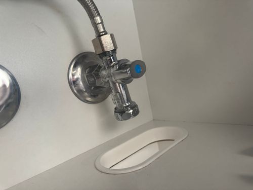

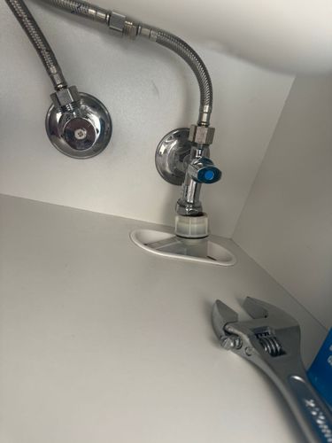

Looking for advice for how to be fit the pipe to the tap, the hole is too small for the connection.
Only thing I can think of is getting an extended pipe, but I don’t want to have several metres of pipe required to be connected.

Can I please confirm if the hose is too short or if the plastic unit on the hose is making contact with the cabinet, restricting it from being attached to the tap? If it's the latter, a plumber should be able to turn the tap fitting anti-clockwise slightly to align it better with the angle at which the hose comes in. Alternatively, you could enlarge the cutout with a jigsaw.
A plumber should be able to cobble together a few fittings to extend that outlet through the cutout, which would alleviate both a hose length issue and the obstruction of the cabinet.

The hose has plenty of length, it’s just the hole in the cabinet not fitting the end of the hose correctly
Re: How to connect a Bosch dishwasher?
If the tap fitting is turned 10 degrees anti-clockwise, I think it will give you the room you need @hutchy. Turning it that little shouldn't cause it to leak; best to check, though.

Just to add to the suggestions made, another solution you can try is to use an ordinary Kinetic 1.2m Washing Machine/Dishwasher Double Ended Inlet Hose on the washing machine tap and linking your Bosch inlet hose to the extension hose using a  Brasshards 20mm Brass Threaded Hexagon Nipple. It will of course make the inlet hose longer, but it saves you a visit from the plumber.
It still won’t fit through the gap unfortunately, maybe a jig saw is the way to go :unhappy:
Hello @hutchy
You'll notice that in your third picture the Bosch hose head shows that it can pass through the gap of the shelf. The reason you can't turn your hose is because of the antileak/burst device attached to the end of the hose. The Kinetic 1.2m Washing Machine/Dishwasher Double Ended Inlet Hose does not have that device and can be easily turned once attached to the laundry tap. The Kinetic washing machine hose and your Bosh inlet hose are the same standard size.
However, if you are referring to another gap, can you please post a picture so that we can see what it looks like?
