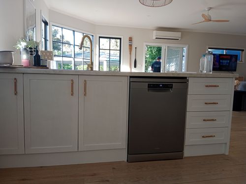

Hey JoeAzza that's exactly what's happening, I have to open one door to get to another, plus they won't open all the way I'm thinking of looking at the different hinges solution
Hi Dave, I have to open one door to open the one next to it, and even then it won't open all the way, I'm thinking perhaps some other type of hinges
before
after
Hi @jblack74
Those doors look fantastic. Let me tag @Dave-1 to make them aware of your question. Putting hinges that open at different angles is worth a try. I suggest going to the hardware department of the store and looking at the kitchen hinge display set. There you'll see how the hinges pivot and lift to avoid hitting one another.
Please keep us updated with your progress, we look forward to seeing your doors working properly.

So a question, what type of hingers are on the doors? Is it the recessed style with the larger round hole drille dinto the door or cupboard?
I am thinking about how much clearance is needed between the door edge and the frame or another door. If its only a mm or two mm then potentially you could shave that off (1mm left and right side of each actuall door) I would suggest to sit and meausure it a few times just to make sure as once its gone it can be a pain to put it back.
If you open one door then mark the edge of the other door on the door frame. Then open that door you should see how much "space" you will need for opening. If this dosnt make sense I can draw a pic ![]()
