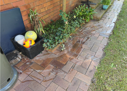

I have noticed a lot of grease build up in the drain pipe at the back of the property and now when ever we use the kitchen water or use the washing machine the water overflows out and its quite stinky.
When i throw boiling water into the drain it does seem to melt away from of those grease build up but it doesn't drain away.
What is the best way to rectify this issue?

In combination with the hot water, I propose using a Kinetic 6mm x 6m Wire Drain Auger. If you think the grease build up is close by. Using the auger will help loosen up the large chunky pieces that have come together inside the pipework.
However, if the build-up is much further away and difficult to reach, I suggest engaging the services of a registered plumber. The plumbers have a dedicated auger that is much longer and is connected to a motor that rotates to clear blockages. Their other specialty tool is a drain rod. It has a rubber disc at the end of a long flexible rod that acts like a plunger and pushes the blockage away.

As we are renting we ended up having our agent send a plumber as the smell was becoming uncomfortable.   They did bring out all those tools that you had mentioned.
