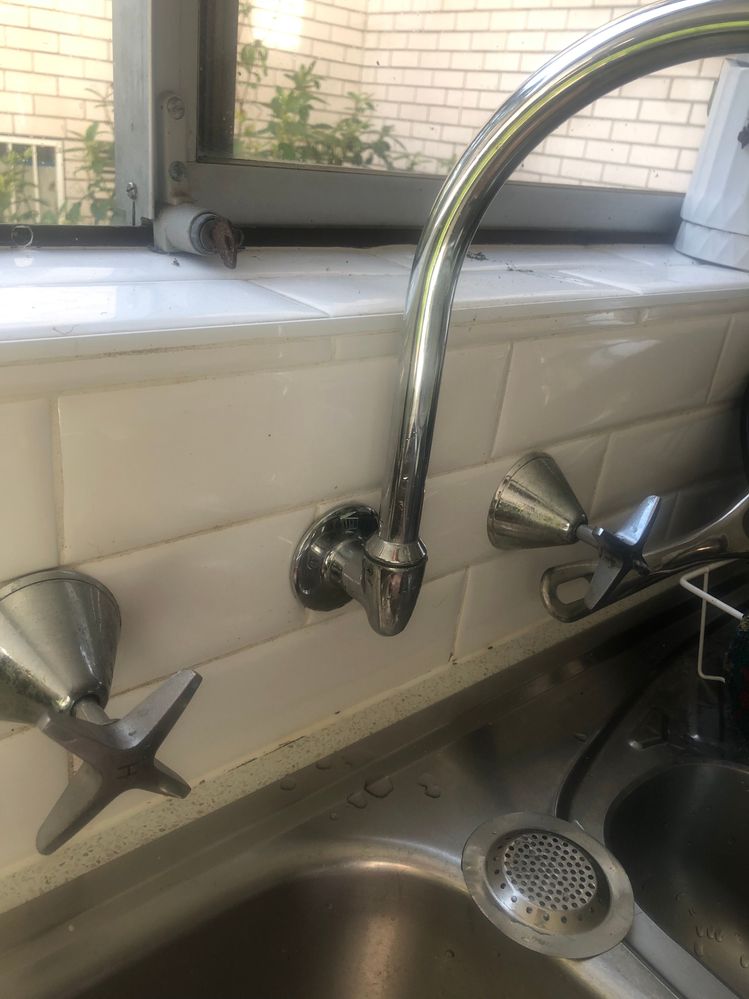

This huge leaking faucet can't be unscrewed as it hits the window, and can't be unscrewed off the wall as it will hit the basin. What do I need to do here?

Could be my eyes - but there appears to be an allen key grub screw on the right.
Remove it (don't lose it).
The spout should now pull off in the vertical frame.
O-rings should be present and most likely worn - they will need to be replaced, assuming it's leaking from the swivel joint.

As @Noyade has pointed out, this spout doesn't unscrew but is held together with a grub screw. Remove the screw and pull the spout straight upwards out of the lower fitting.

Thanks Noyade and @MitchellMc - all sorted now!
