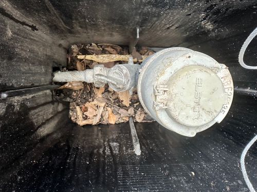

How do I turn off my water main valve?
I’m going to install a new tap in the kitchen and because I don’t have safety water valves under the sink, I’ll need to shut the main water valve. This is usually straightforward but, in my case, I’m a bit clueless as to how to shut the valve for our house. Does anyone have experience with these types of valves? How do I shut it? I’ve tried turning it, but it just won’t rotate.
Thanks in advance!

A. Your water shut off valve seen better days and has partly corroded open. We are talking about the flat blade shape just to the left of the meter.
It dosnt hurt to spray it with wd40 for starters and or CLR to try disolve rust and scale.
I would recommend a medium size shifting spanner (multigrips or lastly large plyiers) and close the jaws snuggly over the top of the flat tap handle . To turn it water off rotate the spanner and valve anti clockwise gentle at first to see if the tap moves. Try a little harder to see if the tap moves.. Now try going clock wise. to help break the rust seal. Now If you can tap the end of the spanner going anticlock wise again give it a few sharp taps.
The objective is to get the seal freed up from sitting in the one position all those years.
B . If no luck so far use a hammer/or the shifter spanner head, lightly tap the flat valve down wards 2 or three love taps to gently try shock and break the seal. Use a couple of love taps (short and shape with no real force) on the flats of the valve either clock wise or anti clock wise.
Now repeat steps at A.
If your hands are not strong at step A place a piece of pipe over the wench handle to increase your leverage. If you see the meter moving and twisting stop! as plumbing can break under super heavy force.
I would use more force after that but I have the sense of a built in torque wrench and know when to stop using extra force before damage occurs.
Plan C I would cut a slot in a metal pipe and place it over the flat tap handle and at the top of the pipe drill a hole in it and put a large screw driver through it for a turn handle this will apply strong firm pressure and stop the tap resisting.

Hello @bonino excellent plan of attack from @Jewelleryrescue I would only like to add that the shifting spanner can be used at a right angle to the valve with a screw driver through the opening (people usually hang them by) for additional leverage in confined areas, the only caveat is this will reduce surface area receiving torque thus a larger spanner (with wider jaws) is a preference 👍

Hey! Just to let you know this worked after I followed the previous advice of using WD-40 and CLR. After I let it soak overnight, it was still a bit stuck, but I got around closing it using a spanner and a screwdriver.

Just a last tip @bonino now the valves working open it and close it a half dozen times just to help free up the valve. In time it will stick again but you know a solution now and if you think of it in other future plumbing repairs ask how much to replace valve as an option. Hope you tap replacement went smoothly too.
