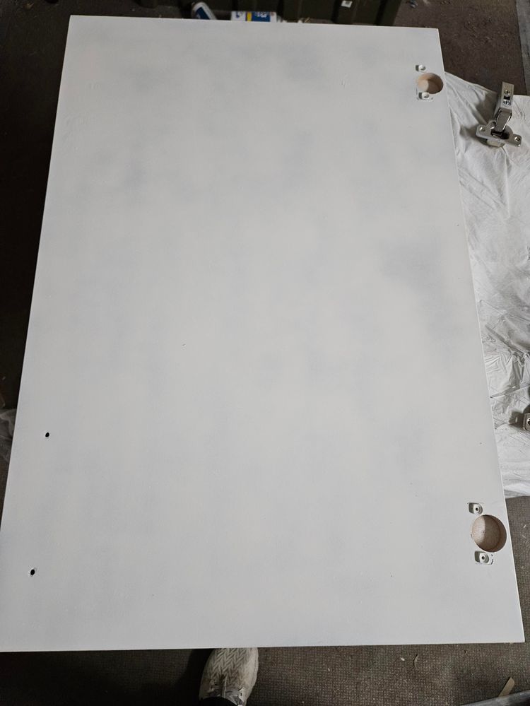

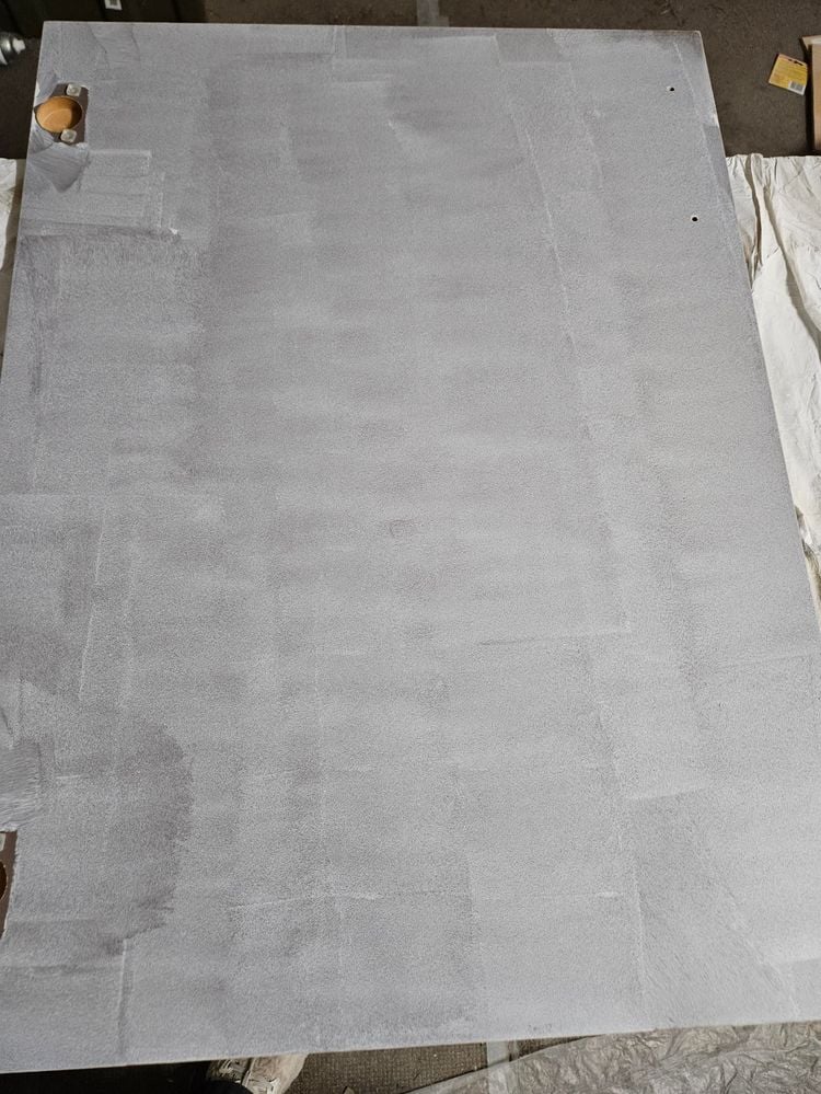

Prime the surfaces with the Dulux Primer, then add the undercoat.  This was done with a roller.
Previous StepNext Step
Step 3
3/3
The used the spray version of the Zinsser undercoat

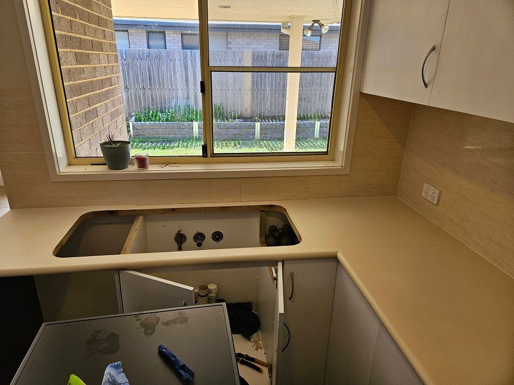

So the next thing I need to figure out is whether to paint the bench or sink first.  I am going to turn the sink black also, using etch primer and some dulux metalshield.  Just trying to figure out if I should do the sink first then the bench or vice versa

Since the sink is often used, I suggest doing the benchtop first and doing the sink last. However, another option is to paint the sink separately, if you've got the time to disassemble it from the benchtop. Having the sink separate will allow you to paint under the lip giving it a nice professional finish.

Thanks @EricL
Might be a better idea to remove the sink, that would also make the painting of that little sections between the sink edge and splashback a bit easier

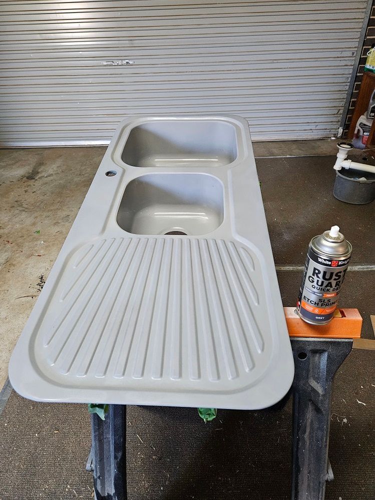

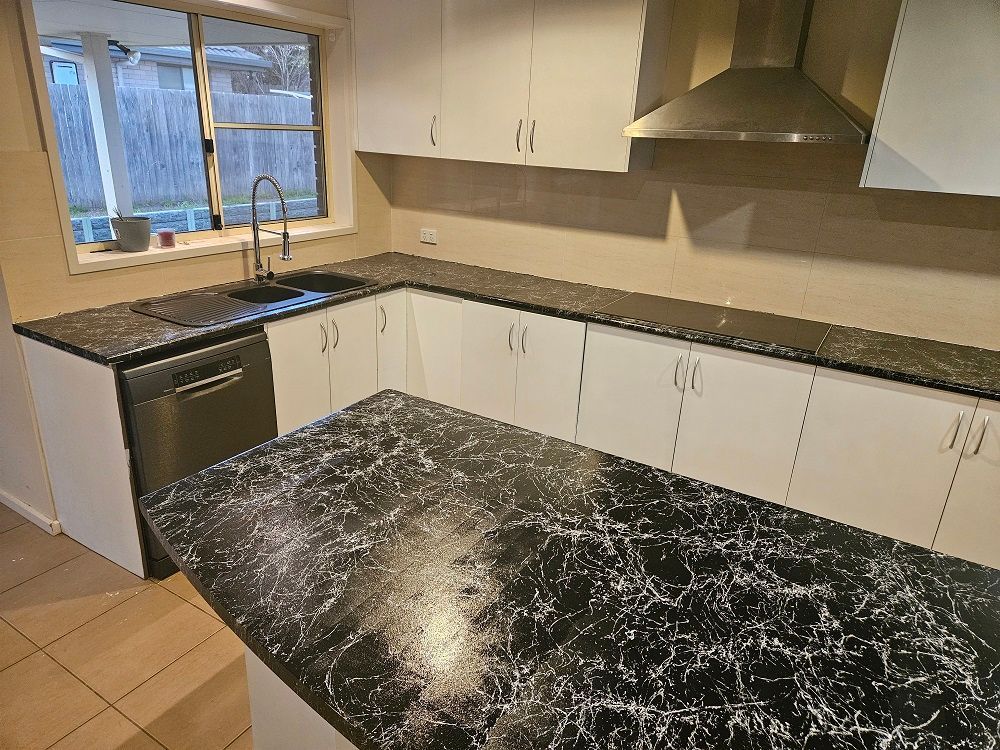

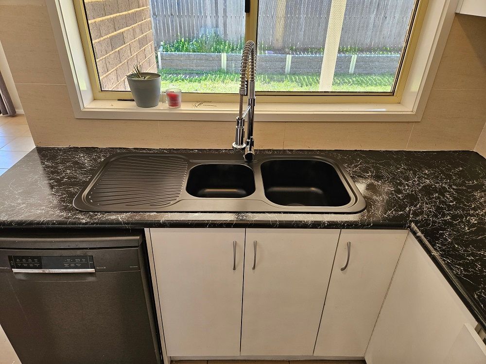

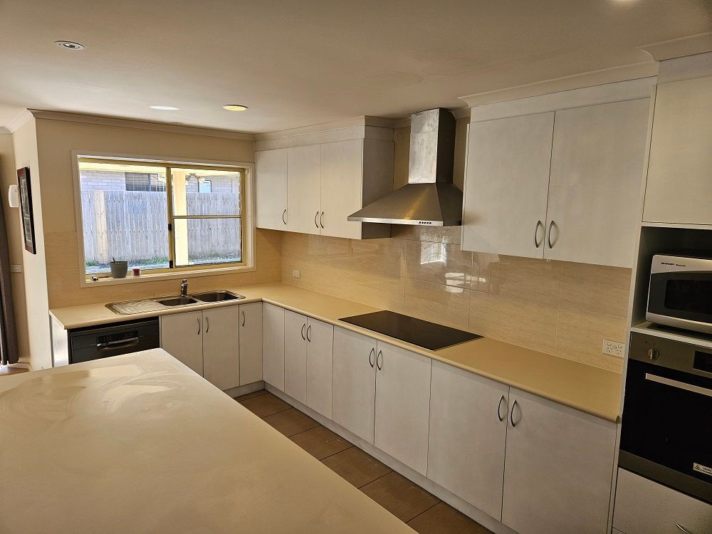

So have finally finished the full revamp, took @EricL advice as he hasn't done me wrong yet and removed the sink before doing the painting.  For the sink I cleaned it all up with pink Stuff, then used White King Rust card etch primer, which gave me a great surface to paint on.  Then it was a spray with Dulux Metalshield epoxy enamel in satin black.  Finally paired the new sink with a new mixer that I got from Bunnings when they did the price match with Aldi.
Next was onto the benchtop, cleaned them all down and used Shelley's knead it putty to fill a couple of spots where the laminate had been chipped off.  For the bench top I used Rustoleums Benchtop Transformation Kit, with the recommended 2 coats giving the benchtop that nice black look.  To finish things off I used Dulux Marble Effect spray paint which I thought brought everything up nicely.
During the process I found the two things that didn't work were the Scotch Blue Painters tape and the Frog Multi surface paint.  Found the only thing they would adhere to was themselves.  Along the edges of the cooktop I used a thin piece of carboard the I slid along as I painted to keep the paint of the edges.
Very happy with the results.

That really has lifted it welll and truly out of its comfort zone! Very nice work indeed. Love the amount of effort that you have gone to!
A question :smile: You have a rough idea on what it cost? That is if you want to say lol. I have all my reciepts form my Libary/garage and havnt added them up as I am scrared to! So totally understand if you havnt thought about it.

Thanks, was very happy with how it turned out.  Total cost for the products except the rollers/paintbrushes and the like as I already had that was $680.  If I was confident enough and had the equipment to spray the primer on it would have cost about $90 less.  The only extra thing I bought was the mixer and that came in at $72.
