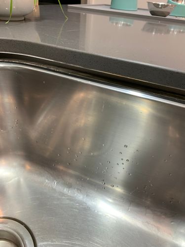

Hi Mitchell. Same issue at my joint. Do you then also have to
seal the top with silicone or is the sika product all in one. Installer used pictured putty type product 5 years ago

Hi @koko, and welcome to the Bunnings Workshop community.
The Sikaflex 11fc is also a sealant, so there is no need to apply an additional silicone sealant.
In your circumstance, it looks like there is enough room to apply the sealant from within the bowl without removing it. Can you tell if any silicone has been used to stick the bowl to the underside of the bench, or was the putty the only thing holding it in place? If silicone has been used, you might need to remove the bowl to clean it from all surfaces. If no silicone is present, you'll need to clean the top lip of the sink and underside of the benchtop with a toothbrush. Once again, it looks like the sink has dropped enough for you to clean the mating surfaces in situ adequately.
You'll then be able to caulk a liberal bead of sealant around the full perimeter of the sink's lip and brace it up against the underside of the bench. You could use a piece of timber cut to the correct size to jamb under the sink. Dip your finger in soapy water and run it around the inside lip of the sink, forming a cove shape transition to the sealant. Allow a full 24hours for the sealant to cure before putting any weight in the bowl.
