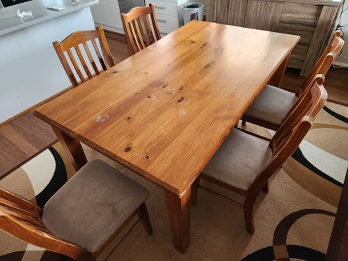

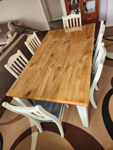

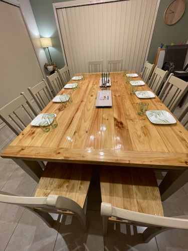

I challenged myself to a Dining Table and Chairs makeover.
I bought the second hand dining set, sanded back the table and seats to remove the dark wood colour using an electric sander bought from Bunnings (OMG 9 hours), and applied a few coats of clear varnish.
I lightly sanded the chair frames and used a paint spray, also bought from Bunnings to spray a light off white tone.
What a difference a little (or lot of) time and elbow grease can achieve.
On to my next project. Thanks Bunnings!
AFTER
 BEFORE

I used the Bondall Monocle Clear Gloss Varnish. Using three coats of varnish over three days, lightly sanding with 400 grit sandpaper in between each coat.

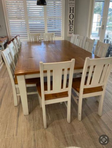

Forgot to share back...
End result before and after!
