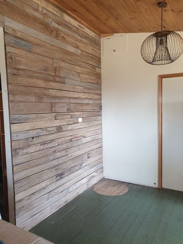

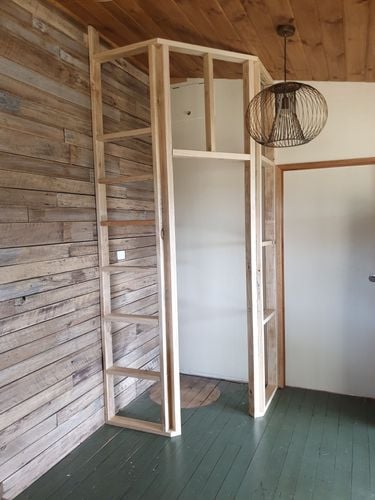

I started this pantry a few days ago.

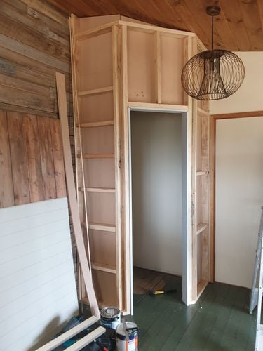

We have recently repositioned our kitchen from the centre of the 120 yr old miners cottage we have bought. The pantry was in the centre of the house so I decided to move it into the corner of the new kitchen area (in a lean to at the back of house) The ceiling is raked and has been lined with pine lining boards so there's a few angles involved. I've purchased all materials from Bunnings and will be lining the outside with vj lining sheets.
As the angles at the front of the pantry are 22.5 degrees, is it better to cut the long sheets of vj board at 22.5 degrees to join or cut at 90 degrees and join with quad?

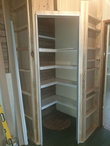

Hi @cattb,
How is your pantry looking now with the door and finishing touches? We'd love to see.
