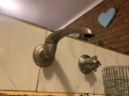

Hello, I have a devanti benchtop dishwasher, which I bought in 2020 from Myer. It cannot be connected to my kitchen tap, as the tap is rather old-fashioned and has no threading.  I wonder if anything can be done about this?  I'm not sure if it's possible, or if I have the capabilities to do so myself; but even if I'm just requesting the landlord consider doing it, I need to know what I'm asking them to do!

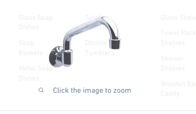

Hi @Upside3318 to fit your dishwasher to your tap, the tap will need to be one that has an aerator, than an adaptor can be fitted to the tap, the dishwasher can then be connected as required. as for draining the dishwasher, I'm guessing that you would place the drain pipe into the sink.
I am not sure if this tap is available from Bunnings, @EricL might be able to check if Bunnings sell these taps.
You will need  plumbers thread tape to install the new tap
You could try also this method, where you just fit this type of adaptor to the existing tap. This is a simple a simple fix.

Hmmm, thanks @JoeAzza ! How does one even replace a tap spout? I wouldn’t know how to actually remove the one that’s there.

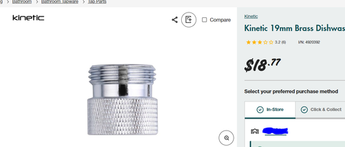

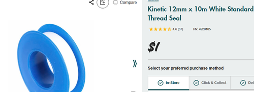

In order to remove the spout, I suggest using a shifter big enough to turn it anti-clockwise. To install the new spout, I propose putting thread seal tape on the brass threaded nipple on the wall and screwing the new spout on. The items that @JoeAzza mentioned are all available at the store such as the Shaw & Mason WELS 3 Star 9L/min 180mm Chrome Plated Tube Wall Spout, Kinetic 19mm Brass Dishwasher Adaptor and the Kinetic 12mm x 10m White Standard Thread Seal.
Those three items when joined together will allow you to attach your dishwasher's hose. Please keep in mind that the aerator must be removed first before attaching the Kinetic 19mm Brass Dishwasher Adaptor. In this particular configuration, it will be necessary to take the hose off when you are not using the dishwasher. Unfortunately, there is nothing we can attach to the large plain spout that would be safe to use.
