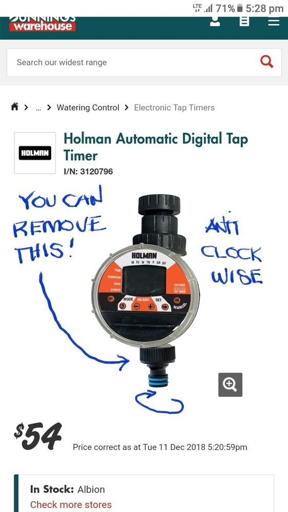

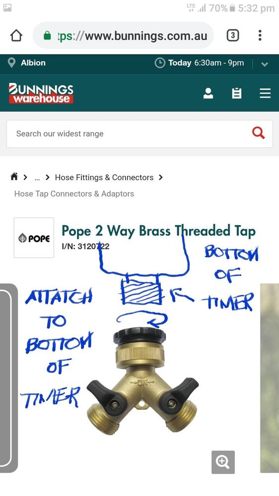

Hello @Newbie21, At the bottom of the pope timer is the garden nipple adapter. Simply remove this by twisting anti clockwise to remove the garden nipple. The fitting at the bottom of the timer is standard 20mm same as the pope brass splitter you purchased. Line up the splitter to the bottom of the timer and twist in a clockwise direction. Attach all necessary garden hoses and check for leaks. Set timer and testThe garden nipple can be taken off.
The splitter can be screwed on.
