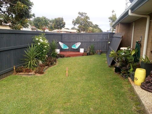

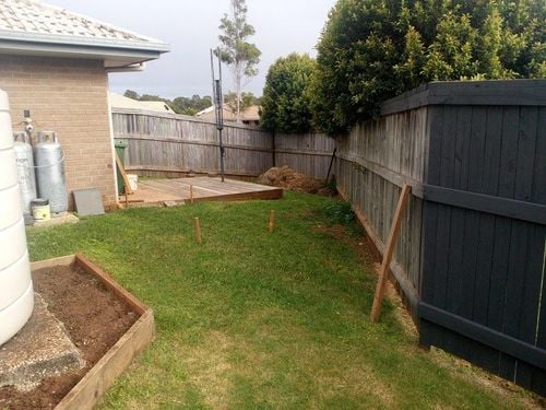

Like a lot of ppl, we have a basic/bland yard. 600m2 block with road frontage on 3 sides (front & LHS facing house are entry/part of cul-de-sac; RHS road is access to estate). As you will see in the photos, we had done some tinkering--painted inside of treated pine fence, small deck & garden beds--while I was procrastinating. We started the reno in April when my wife pushed me to just jump in. Here's where we started...with our plan & the existing yard: right side is approx 14m, back fence is approx 25m

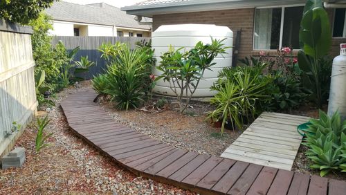

Concrete pad for garden shed was outsourced--approx $1100. Conscripted (adult) children to spread mulch, erect garden shed, help build boardwalk...don't have a complete figure but $350 for 5m3 cypress mulch, $700+ for boardwalk timber (150x25mm plank tops, 800mm wide), $1100+ for semi-advanced plants
2 x Waterhousea floribunda (10m hybrid), Backhousia citriodora, birds of paradise, 2 x Waterhousea floribunda (10m hybrid), Backhousia citriodora, birds of paradise,native & exotic gingers , small palms, Philodendron "Xanadu" native & exotic gingers , small palms, Philodendron "Xanadu"Palms, agave, variegated cordylines Palms, agave, variegated cordylinesboardwalk to clothesline & garden shed boardwalk to clothesline & garden shed

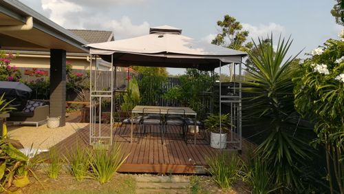

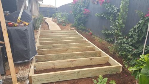

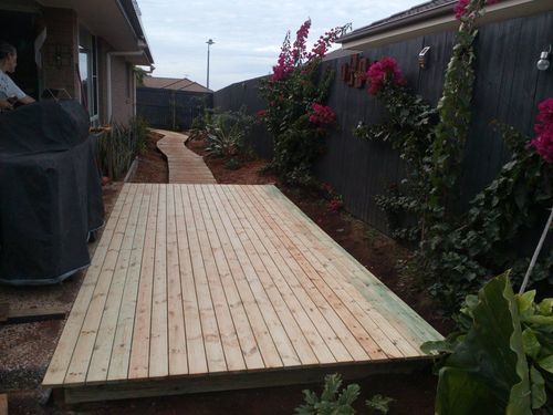

Then about a month later came the side deck--I was finding the construction techniques a bit overwhelming (400mm fall between house & fence) so more procrastination :unhappy: but we got there & here's the story in pics
Starting out on the side deck Starting out on the side deckDone! Done!The al fresco area that's abutted to the back and side decks The al fresco area that's abutted to the back and side deckslooking from al fresco to the side deck with gazebo looking from al fresco to the side deck with gazeboLooking alng the RHS of the house from the front fence to the side deck Looking alng the RHS of the house from the front fence to the side deck
Approx $1500 for timber, hardware, & nail gun hire.
A little  more planting still to do around the water tank... but we've more than doubled the al fresco space so it's gone from being a holding space for BBQ & table to relaxationville! Side deck yet to be tested but we'll be having the in-laws over for dinner in a couple of weeks. Cheers

Here's an update with some photos. Looking along back fence:
Looking along side past th tank to back fence
Looking thru th side deck
