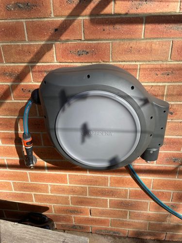

I bought this Gardena 20m hose reel and I want to mount it to brick.
However, several of the reviews mention the supplied mounting plugs/screws are rubbish and failed to hold the load.
What is the best mounting solution for me and in which size? One of the reviewers mentioned Dynabolt but I have never used them before.
The supplied plugs are 12mm x 50mm
The supplied screws have a hex head that is 10mm width, while the threaded portion is approx 5mm width
The wall bracket holes are approx 9mm diameter

I've checked over those reviews just to ensure there isn't anything going wrong with the supplied fixings. I do see three where they had trouble with the installation. However, the vast majority found installation easy and haven't reported issues with the fittings failing. I would be inclined to go with the fixings provided, and if you have any issues with them, you could always swap them out for Dynabolts. However, if you wanted to go with something else, some 10mm Dynabolts should be suitable, but I'd take the bracket in with you to ensure they suit the drilled holes in the bracket. They are relatively easy to install; you just pre-drill the wall and insert the Dynabolt through the bracket and into the holes. Tightening the nut on top secures them.

Thanks @JacobZ, I bought the Ryobi bits and all installed. Drilling 12mm holes was hard work though, even with pilot holes! I guess my XU1 hammer drill is not that good. But I could at least see the bits weren't getting destroyed like the Craftright ones did.

Drilling 12mm holes in brick is definitely hard work.
Regardless, you've done a great job with the installation.
Congratulations and thank you for sharing.
