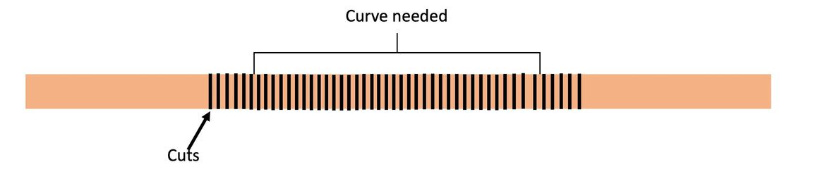

I reckon I'd just use some treated pine garden edging as it's reasonably flexible & cheap enough.
If you need curves beyond what it naturally wants to do then the trick is to use a power-saw to make a series of cuts around 1/3 or 1/2 of the way through the timber from side to side about 10mm apart on what will be the outside of the form-work around the area the curve is needed.
The cut depth can be a little tricky as it varies with the timber so you may need to play around first but again, the stuff is cheap enough to be able to do that.
You'll likely need to make sure you use lots of stakes through the curve to guide it accurately.
Very quick diagram...

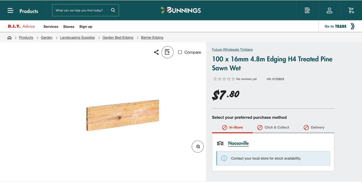

Thanks @Adam_W, the link you provided said thr page cannot be found, do you mind linking through product again?
Thanks for your help, appreciate it.
Re: What timber to use for formwork for concrete edging?
That's odd @ColinL , maybe try a different browser?
Here's the link in full & a screenshot for good measure too :smile:
https://www.bunnings.com.au/100-x-16mm-4-8m-edging-h4-treated-pine-sawn-wet_p0120829
And a tip from experience... If you're looking for something in-store that you've found on-line write down the item number ( I/N ) from the web-page & ask a team member about it's location. In my experience stuff can hide in unexpected locations in different stores due to size & layout differences.
