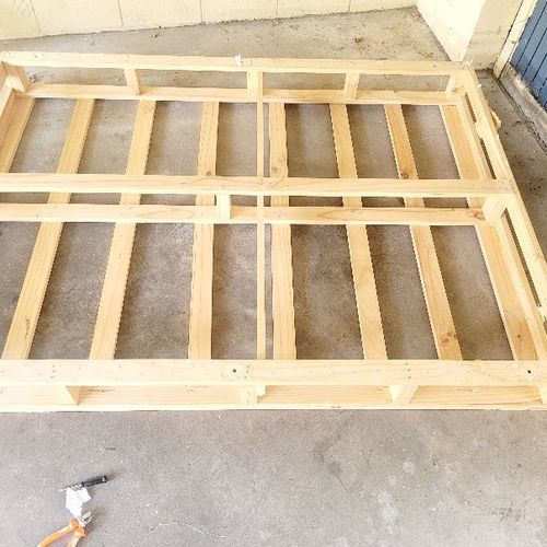

This is what I have got it down too after removing all the upholstery fabric.
Of course I am open to ideas on a different project for this.

Re: Repurpose bed frame to a raised garden bed
Hello @beginnergarden
I propose having a look at these discussions:
If you have plants around the house, you can use the timber to build a plant stand. There are other projects that you can tackle that will only require basic tools such as a hand saw, drill, tape measure and a ruler. Give these simple projects a go, you might be surprised to discover a DIY side of yourself you never knew you had!
