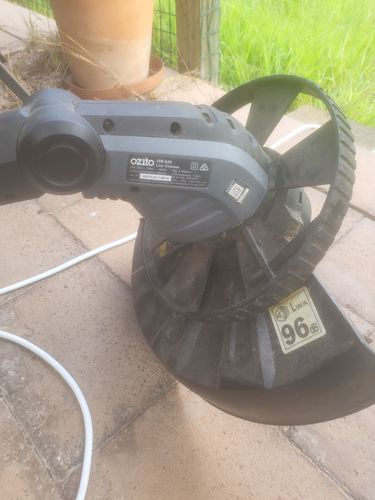

I've had a Ozito LTR-529 whipper snipped for about 18 months now & I went to use it today and the spool doesn't turn, the motor just hums, is it worth getting a new motor for it or another part or just buy a new whipper snipped? Thanks 🙂

Hello @mtisdale sounds like a product failure, would be worth returning to the store for a warranty replacement, do you have a receipt OR bank statement detailing the purchase?

Unless the line has wrapped around the head and locked it in position, it sounds like the motor might have failed. Given that it's 18 months old, I recommend you take the unit to your local store for a warranty swap over. As @Jewelleryrescue mentioned, you'll need your proof of purchase, or the team can assist with finding your receipt; a bank statement showing the purchase would be most helpful for this.

Sometimes grass or twine can wrap around the shaft and head stopping it turning. Cut away any build up where you can.
just in case its fixable.
