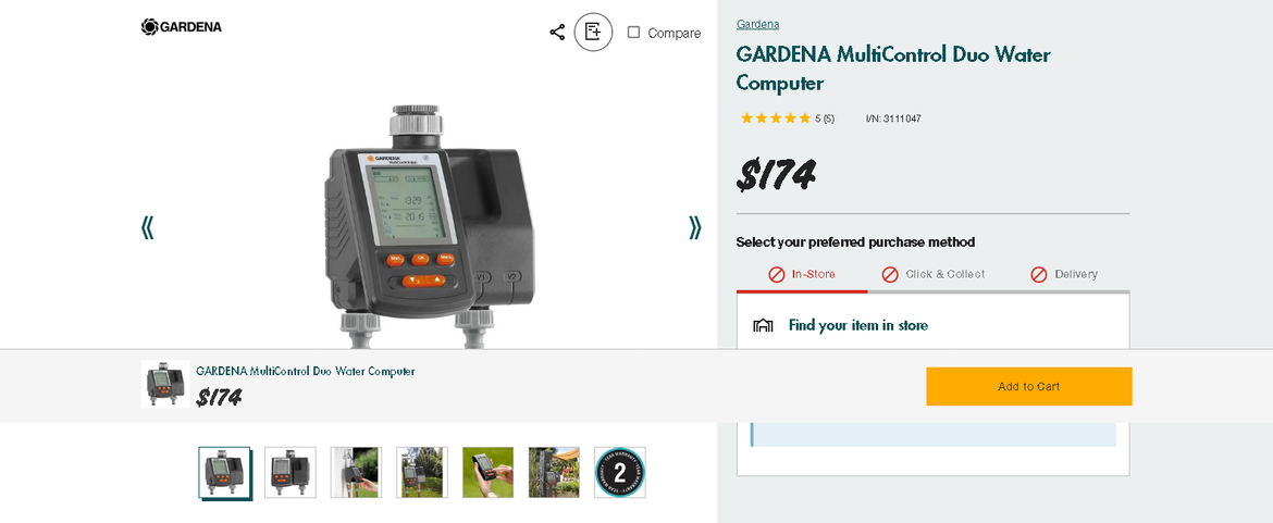

Hello @Harini_sekar
Perhaps you can use the Gardena multicontrol duo water computer. I'm guessing that if you do go away for a certain period of time you wish the unit to be able to turn itself on and off during the week. It is very flexible and is easy to program. I suggest speaking to the gardening specialist at your local Bunnings and see if this is applicable to your situation. I often recommend that if you wish the unit to last, I suggest making a small sun shade for it so that it does not cook in the open air. The more protection we give it the longer it will last. Please keep us updated to what you've decided to use.

This product is for  only two lines. we have a veggie patch with separate line. That s why I thought of using a three way tap with individual tap timer. Do we hve similar product for three outlets?
