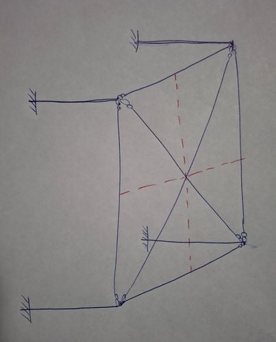

I built a trellis for my vegetable ( creeper variant) with star picket posts and bamboo stakes. It was good for sometime, but due to rain and weather events, bamboo deteriorated and not supporting vegetables any more.
Decided to built trellis again but this time with wire rope(https://www.bunnings.com.au/pinnacle-3-2mm-x-100m-marine-grade-stainless-steel-wire-rope_p4310787) and turn buckles.( Blue lines in picture ). But i am not sure what material / components i need to connect wire rope with wire rope like shown in picture ( red lines)
Can someone help me what to choose to achieve what i wanted. And any suggestions for overall trellis?

To connect the wire in a tee fashion, you would, on one side, loop the red wire over the blue and back onto itself. You can then use a Taskmaster 2mm 316 Stainless Steel Wire Rope Grip to secure it in place, as per the image below.
On the other side, you would do the same but include a tensioner in the connection.
