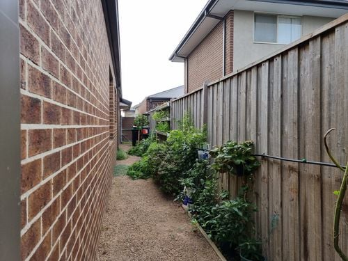

We have a crushed rock walkway alongside our house that's becoming overrun with weeds, making it look messy. We're considering sealing it to prevent weed growth, but we're hesitant about concrete because it would require removing a layer of crushed rock for thickness. What alternatives would you suggest?

What preventative measures are you taking to avoid weed growth? Are you spraying any residual weed killers? Provided you protect your vegetation whilst spraying, applying a path weeder could prevent weed growth for up to 12 months. Using a garden sprayer, the application should only take 30 minutes.
Just to clarify, are these weeds the large plants growing out from the right and left-hand sides? If so, poisoning them would be the most effective method of stopping them from growing across the path.
If you do not want to prevent the weeds with sprays, you could look at laying pavers, provided they don't raise the level up above your brick's dampcourse line.

I dont know of anyway of sealing crushed rock I am afraid. however if you raked the path evertime you mow it would stop the weeds from getting to be anything other then small seedlings. Its a nice looking path and looks like it would handle being raked without damaging the base of it.

Just to add to the suggestions made @Udesh, I would consider temporarily removing or moving the rocks and pegging some weed mat down before reinstating the rocks. Will help reduce the number of weeds sprouting.
