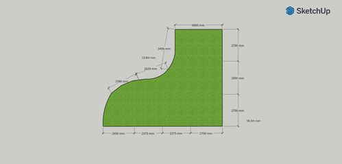

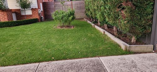

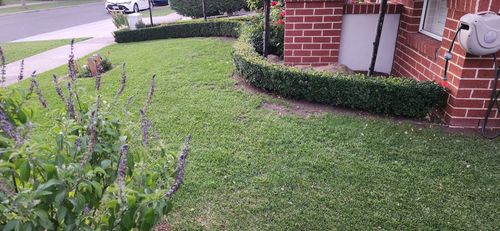

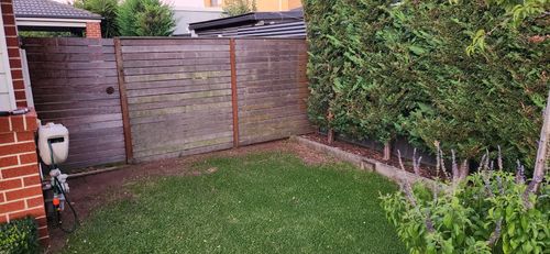

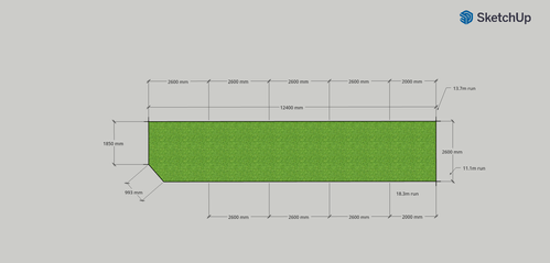

So below is my drawing along with the front lawn for reference, looking at the image I would like to run irrigation around the perimeter of the lawn and the nature strip, if I need to cut into the middle to install a couple of 360° pop-ups, so be it.

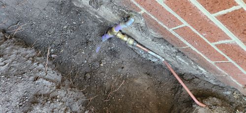

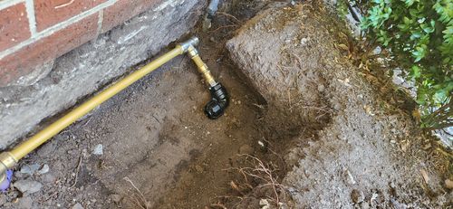

I had installed a tap on the side of the house on a sharkbite Tee that reduced the purple recycled water (i think 22.7mm, I'll have to find the offcut and measure it...) down to copper, so I could rearrange what I had initially done and install another sharkbite Tee where the reducer is in place, this way I can bypass the copper pipes and elbows where Friction loss will occur and run the 19mm poly to the solenoid bank.

For the front lawn, the shape is a little complicated, along the straight edges is easy enough,
•Each corner U-10Q @2.1m radius or the U-15Q at 3.9m radius, if I go with the U-10Q I'll probably need another sprinkler head or two for more coverage
•The garden bed side (right) I'll need the U-10H at 2.1m radius
•The Front would be 2.6m apart (2.6m radius)
•The curves are a little complicated, not sure which style and how many as the only other angle I can use is the 120° which doesn't cover the area properly, which means I'll need more,
•In the middle I'll need some 360° heads to reach every other sprinkler for even coverage.

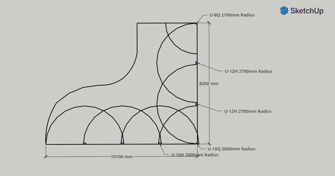

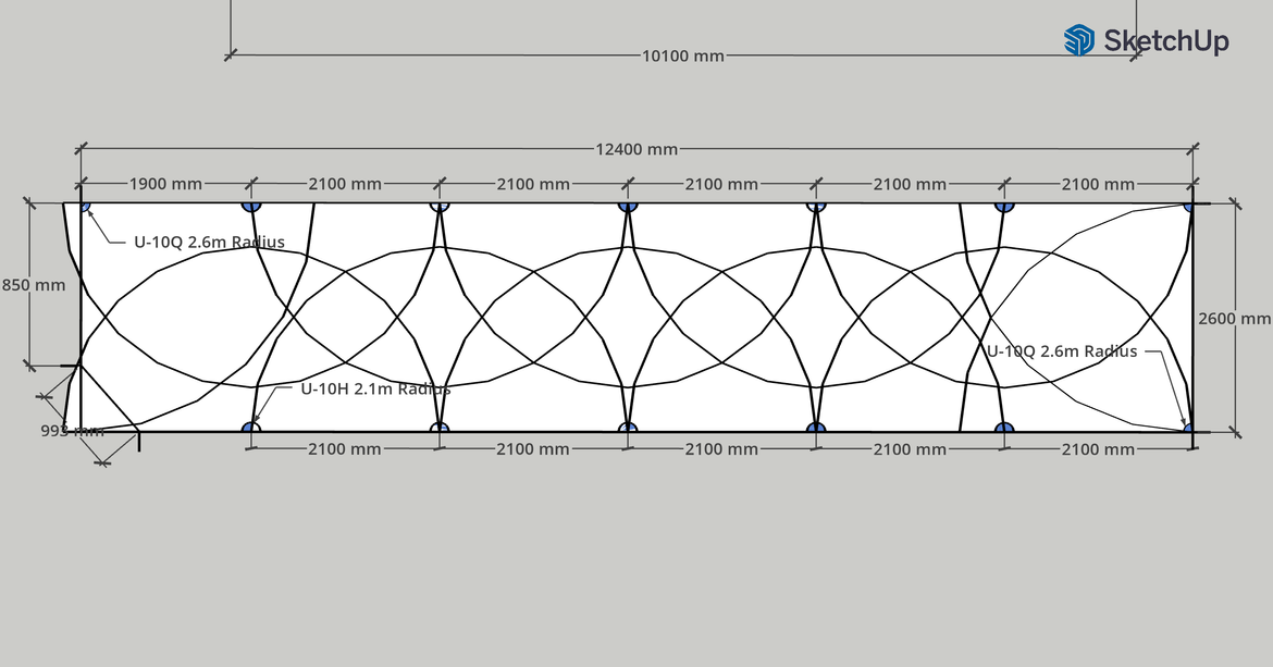

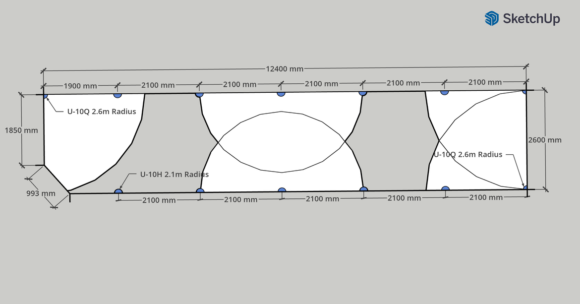

Here I plotted out the nature strip with 2.1m radius sprinklers, the top image is just to show the overlap between two sprinklers, the bottom image shows the entire area with the corners being 2.6m radius to reach the corners, there will be a little overspray due to the spacing of the sprinklers which I tried to minimise as best I can.
using this information how can I make sure that all this is all going to fit into one zone? do i just add all the individual sprinkers' Litres per minute and as long as they are less than the supply flow rate i should be ok?
if so then all of the values as per the data sheet come up to 25.9 Litres per minute, is there any other parameters to consider to ensure adequare flow?

Yes, you will just need to add the total flow rate requirements for each head. In your example, the total combined flow rate of 25.9 L/min must be less than your available supply flow rate. You can measure the flow rate directly at your tap or irrigation line by timing how long it takes to fill a container of known volume. You can use this Flow Rate Bucket Test Calculator to confirm the flow rate.
Leave a small buffer (e.g., 10-20% of your supply flow rate) to account for variations in pressure or potential system inefficiencies from things like friction loss, elevation loss and pressure loss from fittings like tees and elbows.
If your flow rate doesn't meet the requirements of the zone, you may need to split it up.

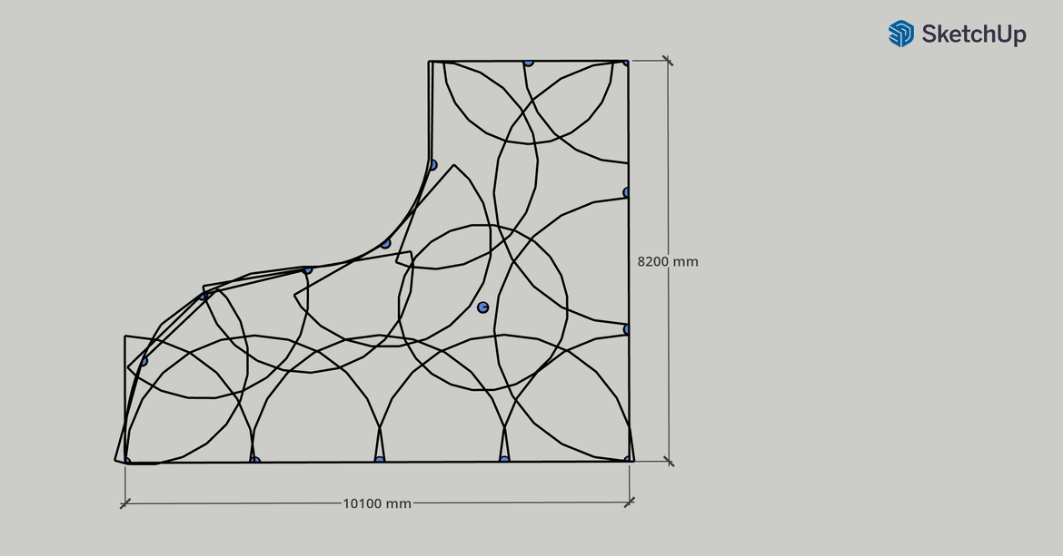

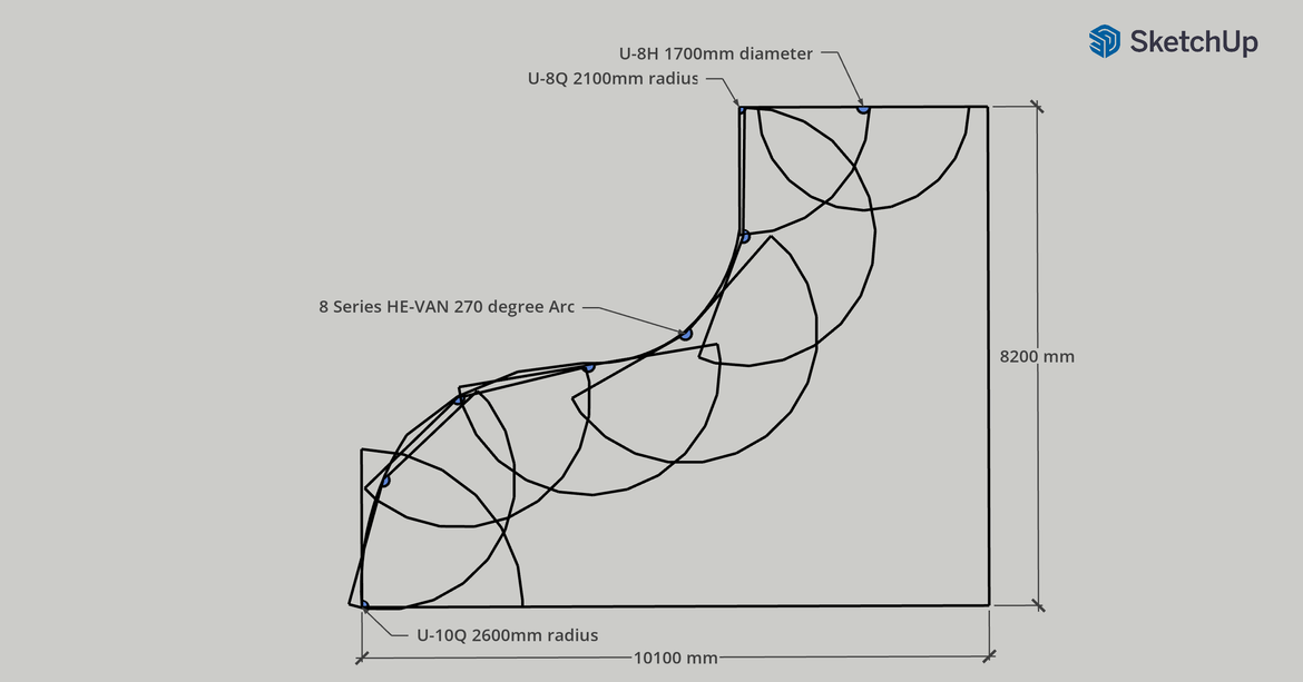

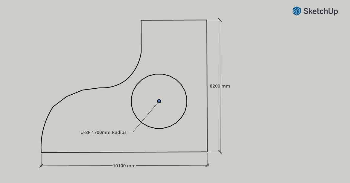

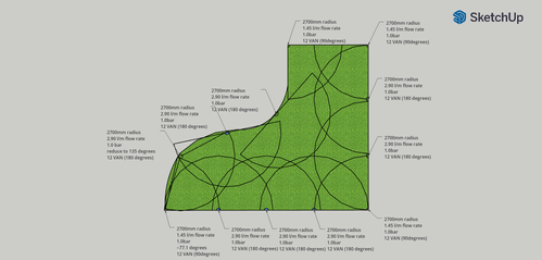

but i think i've planned the front lawn. seen below are the sprinklers I think will be the best fit, on the left curve i decided to go with the High-Efficiency Variable Arc Spray Nozzles, this way I can go beyond the quarter or half radius but keep the garden bed from getting too much water, the rest of the sprinklers probably the U series half and quarter radius, and finally one full radius in the middle to cover the area that the rest couldn't reach, the last image is just an overlay of all of them combined
I did another flow rate rest and it was consistent with the previous one, at 31 l/m
if I added them correctly it seems that the zone would be 33.7L/m, just a bit over the limit, which means i might have to make 2 zones or change the sprinkler heads to make them more efficient so they use less water. at least I have something to work with so I can refine the system. stay tuned!

after a little more research I managed to improve the flow rate with the 12 series VAN all round, coming in at 29 l/m for the front lawn on the tech specs, with a couple of them dialed in, the flow rate should be well within the limits of the zone! I probably don't need a full 360 in the middle of the lawn with the coverage being pretty good.

Any improvements in terms of flow rate are going to be worthwhile and I had thought there could be some minor improvements by using the higher-tier sprayer heads and reducing the water pressure slightly.
Keep in mind once the water soaks down through the grass canopy into the soil, it will spread laterally, so some minor gaps shouldn't be the end of the world as the roots are what matter most.
