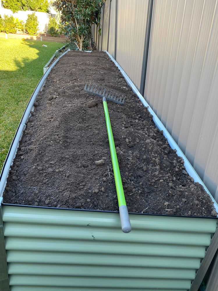

I have placed a 5m x 900mm x 720mm high Birdies raised garden onto my grass, lined it with weed matting, cardboard and organic matter, filled it with premium soil but it doesn’t seem to be draining water adequately. Can you suggest how I can fix this without removing the soil?

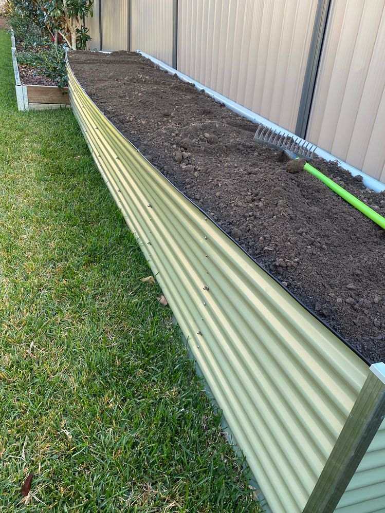

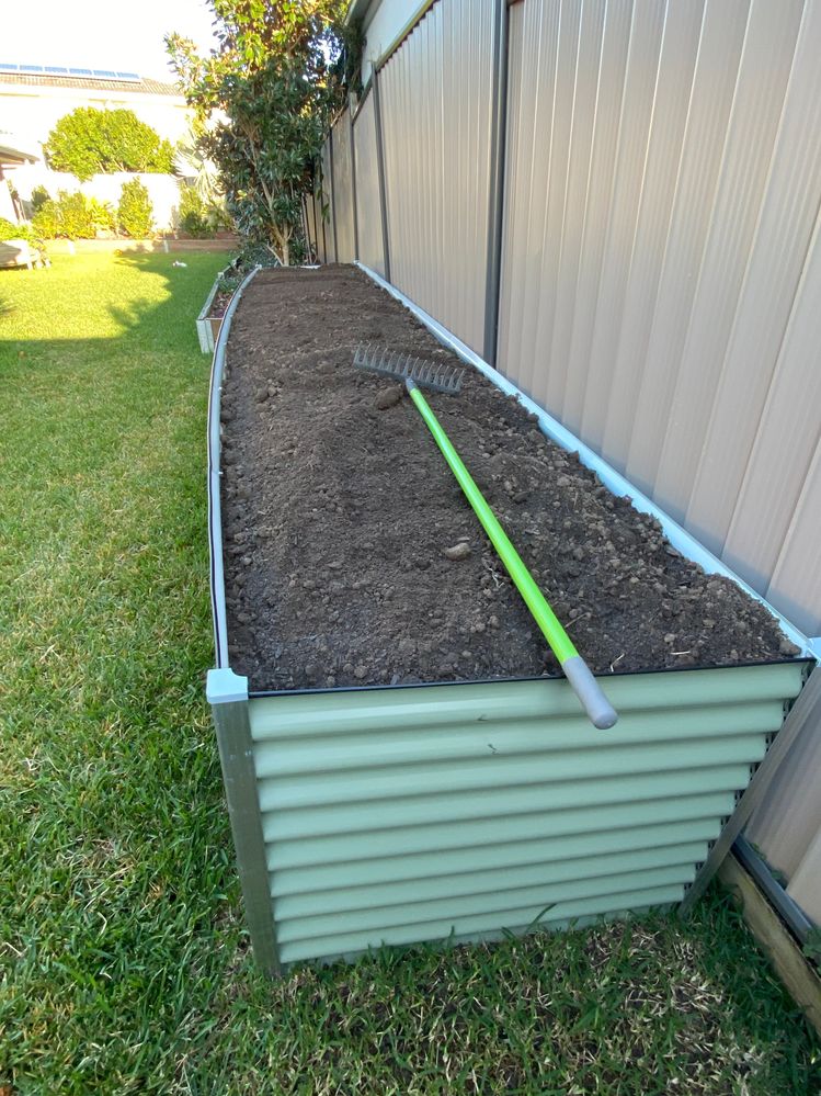

Could be an optical illusion. But the corrugated iron wall on the left looks to be severely bulging out with the weight of the soil?
I'm thinking Dam Busters.

YES!! that is the other issue! I installed as per the instructions with all the lateral braces installed but it seems to me that more lateral support is needed. I contacted Birdies and asked the question "Will it be a problem going forward". They didn't answer that question so i don't know if I need to rectify it or will it be okay. What do you think? I really don't want to have to remove the soil because I have planted out the garden with my vegie seeds. Thanks for that observation!

I've spoken to the team at Birdies, and it appears that the high quality of your soil could be the issue here. The supplied bracing is designed to support the bed when it's filled with potting mix. Potting mix is typically a much lighter medium containing a large portion of bark and doesn't retain as much moisture. It's advised in the installation instructions that if heavy soil is to be used, additional bracing is required.
This bowing isn't something they've experienced before, and they are more than happy to send you out some additional bracing for the top section. I'll reach out via private message to get your details.
