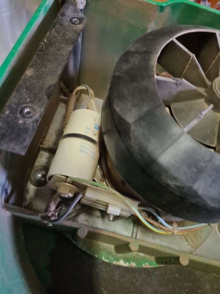

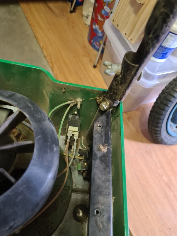

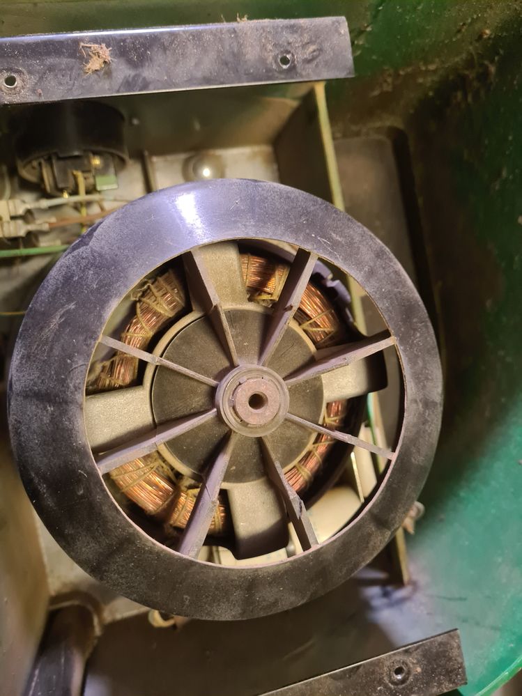

I bought second hand mulcher, Rover Muncher (I believe the model number is 97361) and it was working well but now when I try and use it it will spin up for about 5 seconds then there is an audible click and it switches itself off.
I believe it's an auto shut off being activated but I don't know how to find it and fix it.
I've attached images of the underside (with the cover off) in case that helps?

As a failed Electrical Coroner - I do share your frustration when electrical devices fail Christopher and tend to open them up to try and see why. In your second photo I see a large capacitor and what looks like another switch(?) that has an active/neutral supply but not seen in the exploded view? And I don't see how that on/off switch can double as a thermal switch without some sort of thermocouple input?
But spooling up and tripping after 5 seconds is a real worry. We really don't know why.

To clarify my statement @Noyade, I was referencing current new machines that have a thermal cutout. For this machine, I'd suggest that the ON/OFF switch might act as a simple overload cut out and is tripping due to a motor fault.
