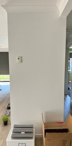

i have added the image of wall i am thinking about. (Excuse the mess)
My idea was to have the upper and bottom and right side section done leaving the heating panel but have ivy’s cover it so can be accessed when needed.

I will start by saying that you should take into consideration the proximity of the plant wall to an electrical source. Allow me to tag some of our resident electrical experts for their opinion: @CSParnell, @MikeTNZ.
Please be aware that your heating controller would indicate that there are wires within the wall and therefore a live electrical source. If this is the only wall you could have the plant wall on, you should contact an electrician to have the heating controller moved.
Once this is handled, liquid nails will be suitable to stick the corflute on but if you are already drilling into the wall, you might like to add some Otter 8g x 32mm Matt Black Button Head Screws for added strength. A combination of glue and screws is always the best for holding power. You should purchase a stud finder to ensure you are hitting the timber as this is the best way to support any weight on a wall. If you are not confident doing this, you should contact a handyman for assistance.
