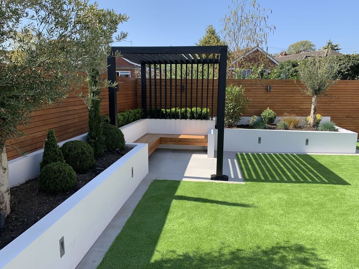

I am willing to make garden bed and sitting area as shown in this picture. But have few questions :-
1) Are these beds made out of concrete and then rendered or it can also be build using timber and then attach rendered board on top of them to give them similar look ?
2) Is the flooring next to turf is concrete ? Garden inspiration
Hello @nirmal678
Welcome to the Bunnings Workshop community. It's marvellous to have you join us, and thanks for sharing your question about building a garden bed with timber seating.
Both your suggestions regarding the wall structure are actually valid. If it's made from concrete odds are they used Besser blocks or bricks and then rendered the surface. If it was made from timber, it's possible they used sleepers and built a timber frame around it and covered it with Cement cladding and rendered the surface as well.
As for the timber seat, it's possible that they used angle brackets to anchor the timber seat to the garden wall. The flooring you are looking at is probably made of a Tuscan Path 600 x 600 x 20mm Sand Porcelain Paver or a variant of it. The gazebo appears to be the Mimosa 3 x 4m Lava Portsea Louvre Semi Permanent Gazebo.

Can we install these pavers without the use of concrete ?
Another question is do I need to core fill these besser blocks with concrete as well as the height would be than 800mm
Hi @nirmal678,
Those porcelain pavers can be installed on a sand base. Here's a helpful guide: How to install Tuscan Path porcelain pavers on a sand base.
At 800mm high, if they will be used as pictured to retain soil and especially if you are rendering, then you should core fill the Besser blocks and install rebar through them to ensure they don't shift.

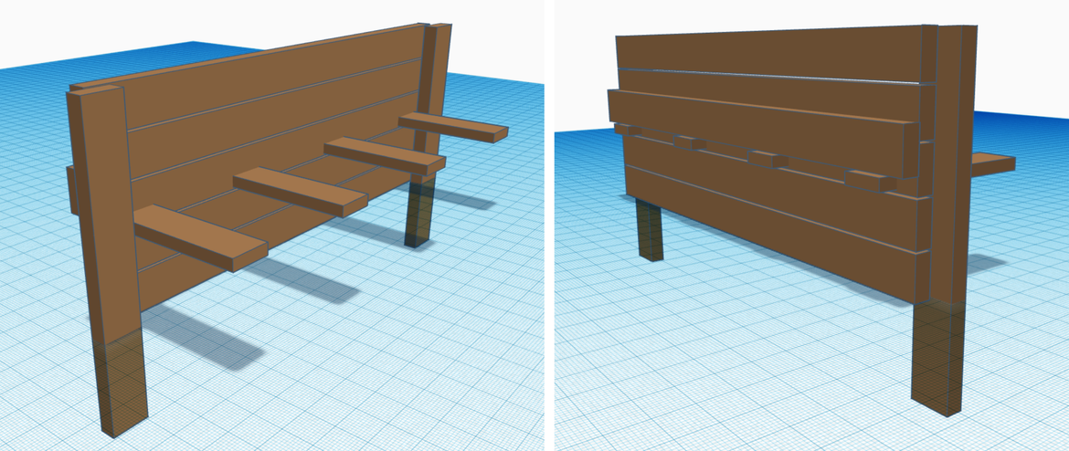

1) How I can connect this seating bench to the walls which I will make from the sleepers ? Will sleepers be strong enough to carry the weight of the hanging bench and people sitting on top of it ?
2) I can see inner walls of the garden bed are also rendered and its in direct contact with the soil. Will that render get spoiled overtime ?
Hi @nirmal678,
It would be best to install sleepers into the wall to create a floating seat like that. You'll notch out one of the retaining wall sleepers to accept them. At the rear of the wall another sleeper running along the top of the inserted sleepers is used to lock them into place and to fix into. This leaves you with very solid mounts to build your seat off. Due to the forces involved in a counter-levered seat, there are no brackets you could use. I've put together the rendering below to illustrate.
