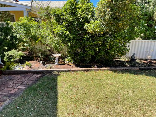

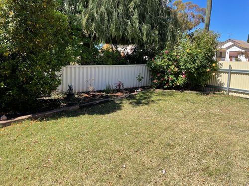

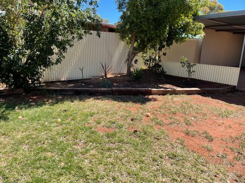

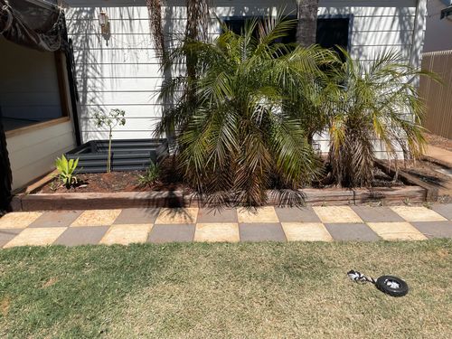

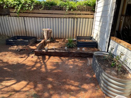

thank you for your replay. Please see pictures below. I just want to replace the sleepers with limestone or something similar. Just something basic but nice and that won’t rot away like sleepers. There is about 40 meters worth all up (front and back yard) give or take. I mainly just want to know what I need to do and what I need
Hello @Cozza
Thank you so much for posting those photos of your garden. There are two materials that I would recommend to replace your sleepers. First is the Brighton Masonry 200 x 100 x 50mm Cream Mypave Paver. This would be the easiest to lay and link together to create long-lasting garden edging. The second is Ezi Wall Lite Retaining Wall Block Cream. It is a bit more expensive but it is twice the height of the Paver. You will need to use Selleys 415g Liquid Nails Landscape Stone Concrete Adhesive to glue them together.
The area where you will be laying them down on must be leveled and compressed so that they will stay even and not sink into the ground. It sounds like a fantastic project, any updates you can provide would be much appreciated.
