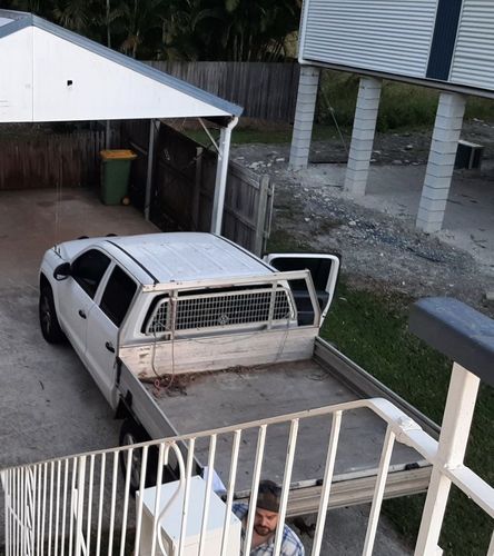

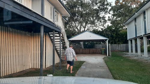

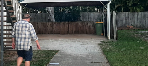

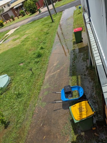

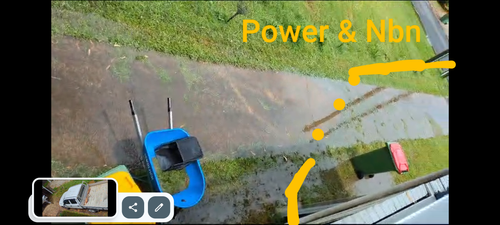

Please see attached photos. The water starts just before our carport and comes in pretty hard for the length of our carport, then runs both across the carport into under the house a little (which is just crusher dust) down the side and on our driveway.
The plants and fruit trees are my neighbours and she wants a green fence, but also needs a pool fence for her swimspa. We asked a landscaper / earth mover about building a french drain, however, he said it wasn't a good idea..Our power and nbn runs underground and underneath our driveway to the house and BYDA don't have plans of where they run as we are on Russell Island. Additionally, our property (and driveway) slopes upwards as it approaches the street and water always
pools out front of our driveway on the road (the landscaper said that he heard the council messed up our street as the storm drains on either side (and 3 doors up) are uphill from mine and my neighbours houses).
The soil is red and extremely hard when dry so it's not something we can realistically do by hand for such a long distance and the earthmover guy said he wasn't prepared to take the risk. He suggested building up our driveway to act as a wall, but that will be quite expensive and we already want to get concrete poured under our house.

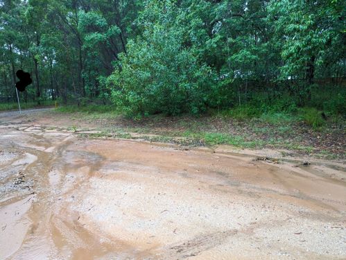

I am waiting on the Council to respond. Although when I contacted the same council about the "road" in front of my mum's house (also on Russell) and the dirt that now gets washed down her driveway ever since they built storm drains and roads leading to her street, but stopped at her corner, they were not at all helpful. And said we needed to raise her driveway entrance from the road so as to stop it. However, if she did that it would be more likely to run into her front yard and house instead of down the side of her house following the driveway unless we installed our own kerb and storm water drainage in front, which I explained and am still yet to receive a response since 30 Nov. So am not super hopeful. Haha.
Pics of my mum's street.

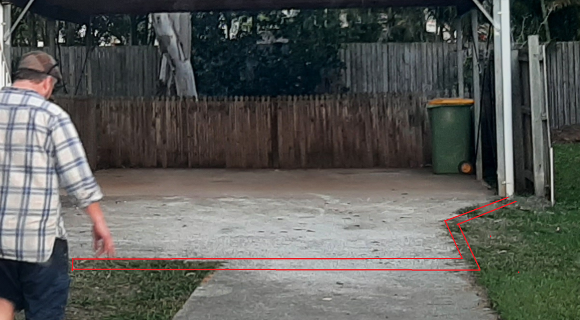

I see there is a downpipe on the carport, and you appear to be indicating that the majority of the water flows across the concrete section. What if you installed drainage channel as per my illustration below? It's great at capturing surface water and would mean a minimally invasive dig. That might work for the water that comes through your yard, but if it builds up from the neighbours next door to you, it might still flood under your house. I suspect a secondary drainage pit would need to be installed at the lowest point within the ditch between the two properties.

Sorry @KatQld. It appears I didn't attach the image, which would have given context to my previous comment.
Let me know what you think.
