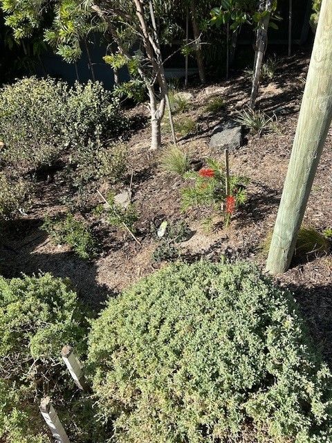

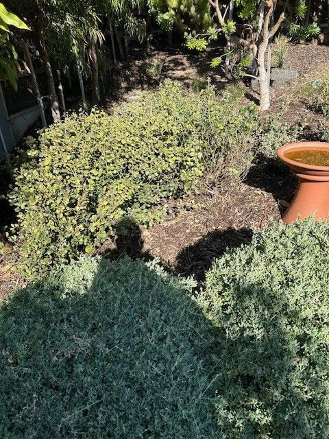

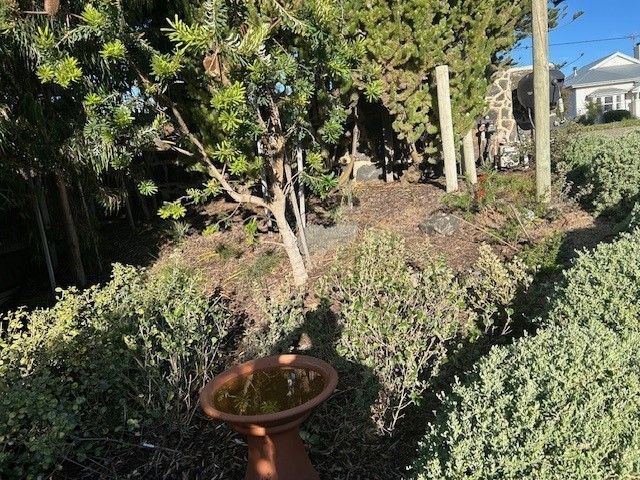

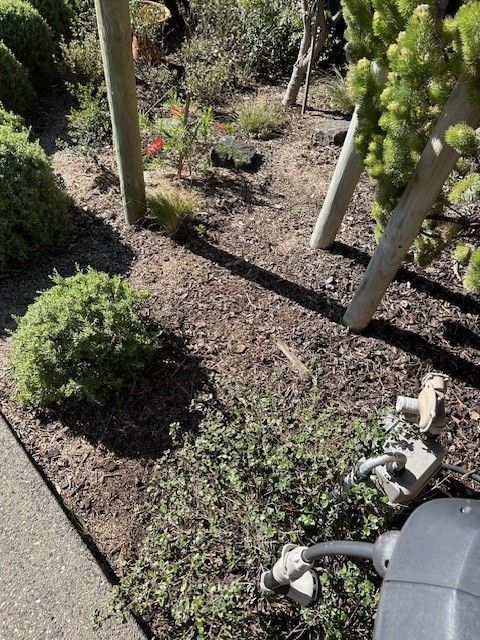

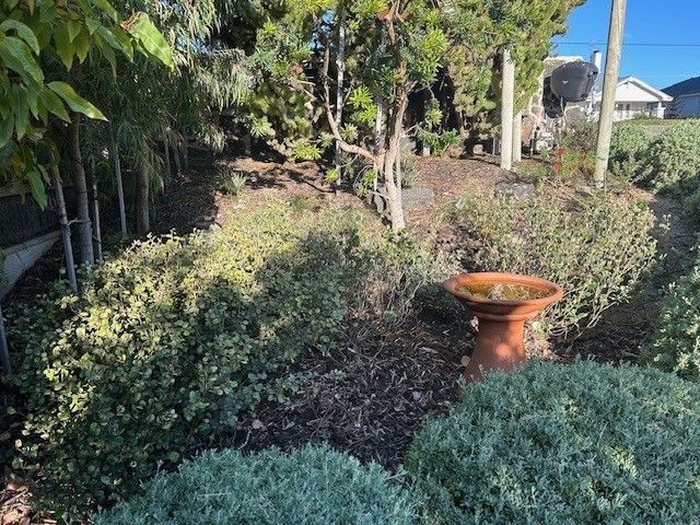

Hello @Graham81
Thanks for sharing those photos of your garden. I take it that rainwater landing on the concrete pad is being directed towards the slope. Diverting or catching the water is not difficult, but where it will get diverted to is another matter. There are rules and regulations regarding the redirecting of water, especially if it goes towards your neighbour or into an area where it might create a flood.
However, to give you a few ideas of how to catch the water, I propose looking at the Everhard 3m EasyDRAIN Compact Polymer Grate And Channel. A slight channel will need to be dug out so that the surface of the EasyDrain is parallel to the concrete pad. Any water coming along will get caught by the drain and redirected.
Another option is to put a stand-up ledge on the end of the concrete pad using Brighton Masonry 200 x 100 x 40mm Cream Mypave Paver. Placing this ledge will serve as a diverter for the water flowing on the surface, but as I mentioned it must be diverted safely to the proper channel.
One more way to divert the water is to install a French drain using Vinidex 100mm x 20m Socked Slotted Draincoil. The general steps are to dig a channel in the soil and cover it in geo fabric. A light layer of gravel is placed at the bottom and then the agi-pipe is placed in and then the top is covered with more gravel. When water hits gravel it is diverted into the pipe and the water is directed elsewhere.
Before you begin, I propose speaking to a plumber regarding the drain layout and finding out if the runoff needs to be diverted into your stormwater pipe.

Hi Eric,
The problem is not the concrete pad but the slope which brings water to flat areas close to the concrete and sits there so plants become water damaged and eventually die
I am reluctant to put pipes in because there would need to be a number of plants removed
I am looking for the simplest option to divert the water before it settles around the plants Is using screenings an option and if so which ones?

Hi @Graham81,
It's difficult to answer your question without knowing how you intend to use the screenings to divert the water. Screening is typically a small stone and does not have water diversion characteristics; the water will simply travel through it. Perhaps you are describing a screen, as in a physical border. In that case, plastic garden edging could be used to help divert surface water before it reaches these low spots.
