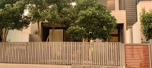

I am renovating my courtyard and plan to remove the trees. I want to extend the existing fence and gate to be higher, aligning them with the white walls on each side. While I could have the fence rebuilt, I’m considering a DIY approach. It needs to be about a meter or more taller. I’d also like a new gate that matches the wall height for aesthetics.

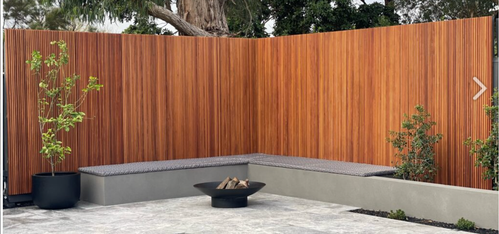

I was thinking of screwing lattice into the existing fence for a similar look to the image below.

Is it possible to get some clearer photos of the gate and the fence? This will help our members offer their best advice.

I think your key word you used is aesthetics as part of your project goal bucket list. I am not sure you will achieve it with a lattice extension? as a reflection on your words.
But here goes, Typical lattice is usually best made with a timber box around it think picture frame supporting the canvas in the middle. See Lattice capping Notice the hollow section for your lattice to sit in. This box frame surrounds the lattice or other flimsy timber but nice-looking fence extensions and will support it for a longer period of time as lattice stand alone will fall apart in 3 to 4 years as they are made of thin staples holding it together, painting it will help it last longer here.
The square edge of the lattice Capping could sit on your fence. To make this work you need Framing H3 pine lengths bolted and screwed to your existing up right fence posts Then make picture frame like lattice panels to fit in between the post extensions. If possible dig on the inside of the fence post holes to extend the new tall upright posts into the ground 600mm for a stronger result.
As a side note you can use the Lattice capping rails and form a box picture frame and basically insert any screening material you want and or use treated timber pine vertical timbers inserted and attached to the lattice framework. match your existing fence pattern instead of lattice this will improve aesthetics.
