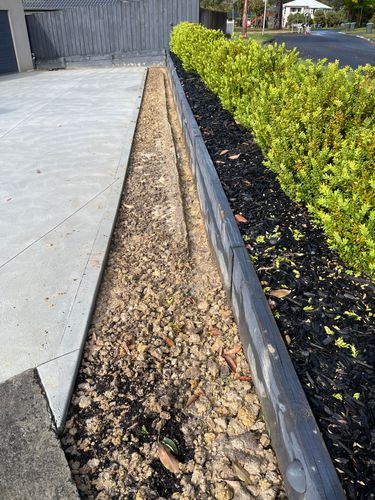

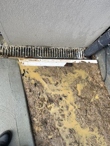

The water is stuck in my soil (obviously clay soil) which raised my concern. I tried to dig a ditch and planed to install a ag-pipe to guide the water into the surface drainage system in front of my garage. However I found that there's no way to connect the ag-pipe to the existing drainage ditch.

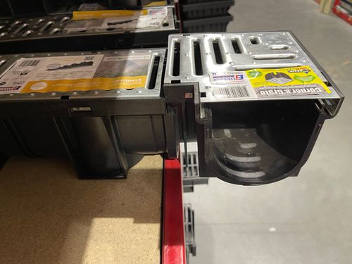

I went to Bunnings and founda potential product like this below, but it looks like I don't have enough space for a corner connector. What's your suggestion?

I think the easiest option would be to remove the soil in front of the drainage channel and then drill an appropriately sized hole in the side wall of it with a hole saw to accommodate your new drainage pipe. The pipe can be secured in place with Sikaflex 11FC, or you could use concrete around the joint. Alternatively, you could cut the existing drain back and insert a drainage pit in the corner, allowing you to connect your new drainage pipe to it.
You could use the corner section you've found, but you'd need to cut back the existing channel to be able to fit it in.

To answer your question, the concrete patio area slope from the front yard/street to the house/garage, and there's a long surface drain channel in front of the garage with no issue so far. So if I install the ag pipe along the trench shown on the photo, the water will flow to the channel area in front of the garage door. That's why I want to connect an Ag pipe directly to the existing channel. Hope I'm on the right track.

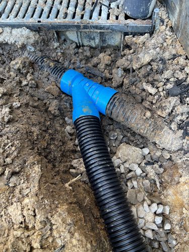

Hi @EricL thanks for following up! I can't wait to share the outcome here and I just finished today.

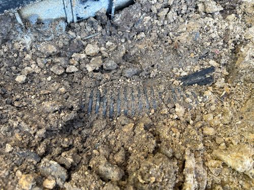

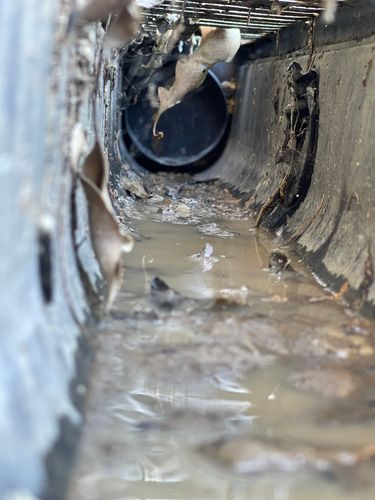

First of all, I'm so lucky. I supposed to get rid of the clay soil surrounding the surface drainage to check the drainage size. When I dug out the clay soil, I saw there's already an ag pipe under ground which has been already connected to the surface drainage. I did a test, the water came through!
That means I don't need to drill any holes haha, save a hole saw set!
Then, the topic became "how to connect 2 ag pipes", which is much easier.
I went to a Bunnings store and talked to a very helpful staff to check if my plan is good and achievable.

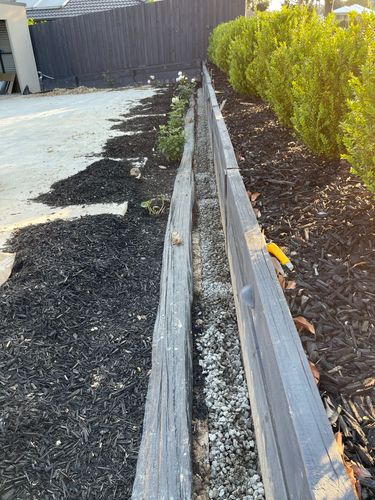

With his guide and recommendation, I bought 65mm ag pipe (20m), a pipe connection kit. After that I bought 14 bags of blue metal stone from another garden supplies warehouse.

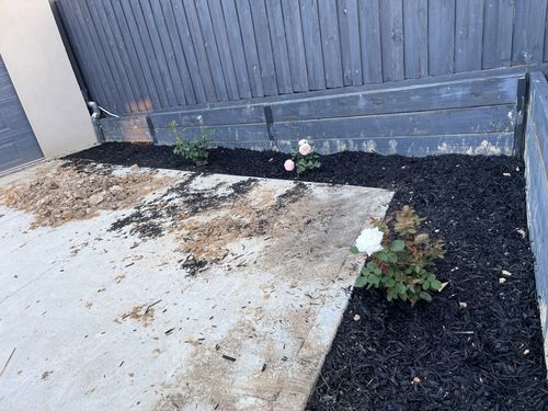

I spent 2 days to finish a nice and clean trench (so tired, I'm really bad at physical), and another several days for installing the pipe after work. For installation, I firstly put stones as underlay, and placed the ag pipe, then filled with stones, like other people did on YouTube video lol. Final step, instead of covering it by well drain soil, I covered it by a fabric mat then mulch.
Fingers crossed. All the best to all my roses.

Hi @superkay005
Thank you so much for that update. That looks fantastic, what an awesome transformation. You've definitely covered all the bases with the gravel and mulch. This should provide you with good drainage for a long while.
