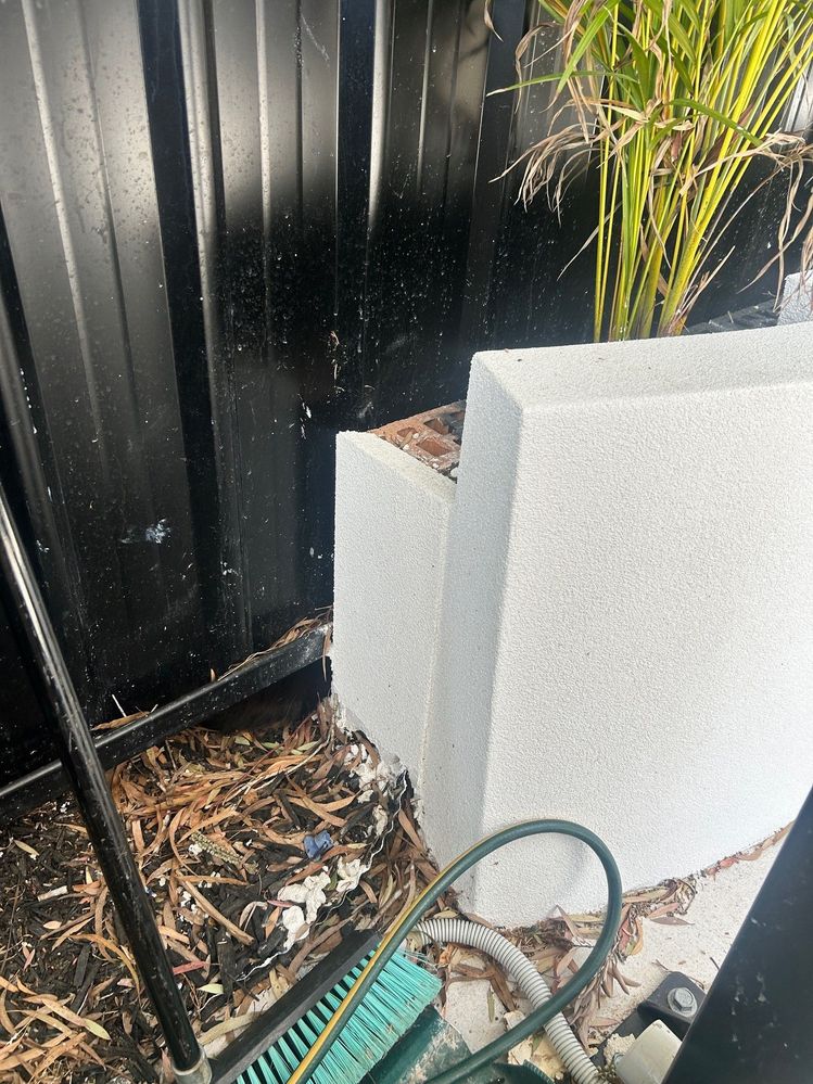

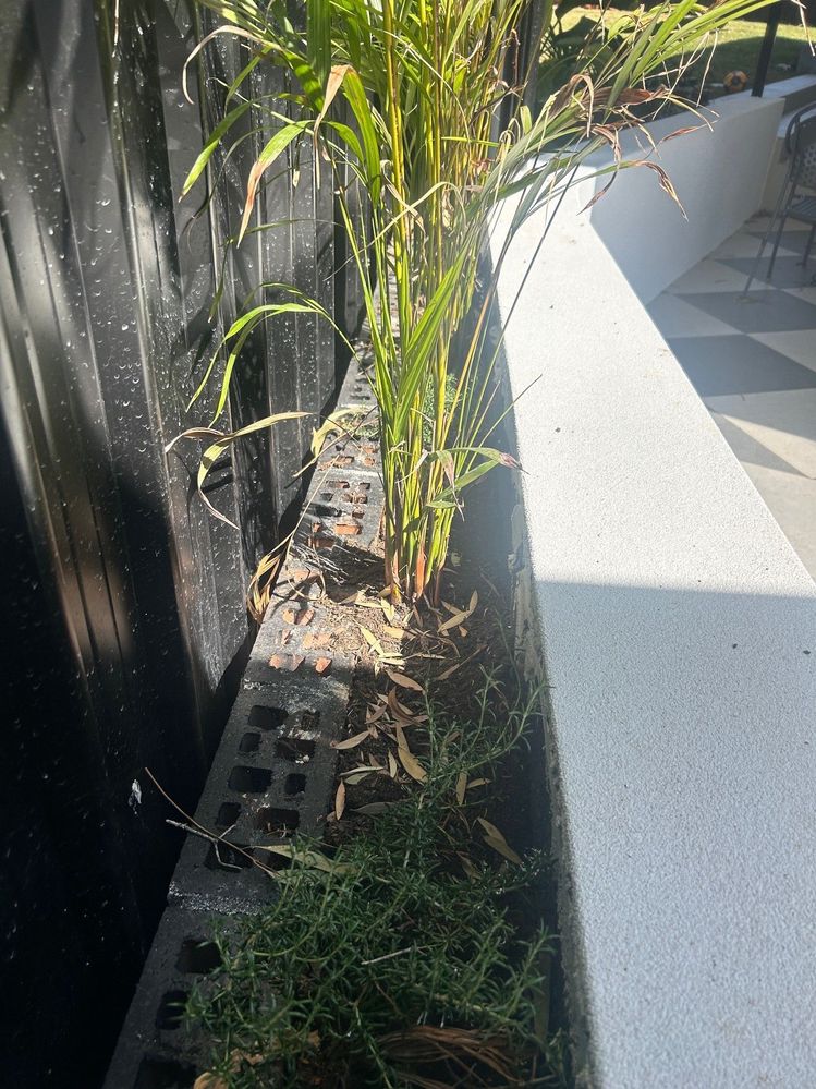

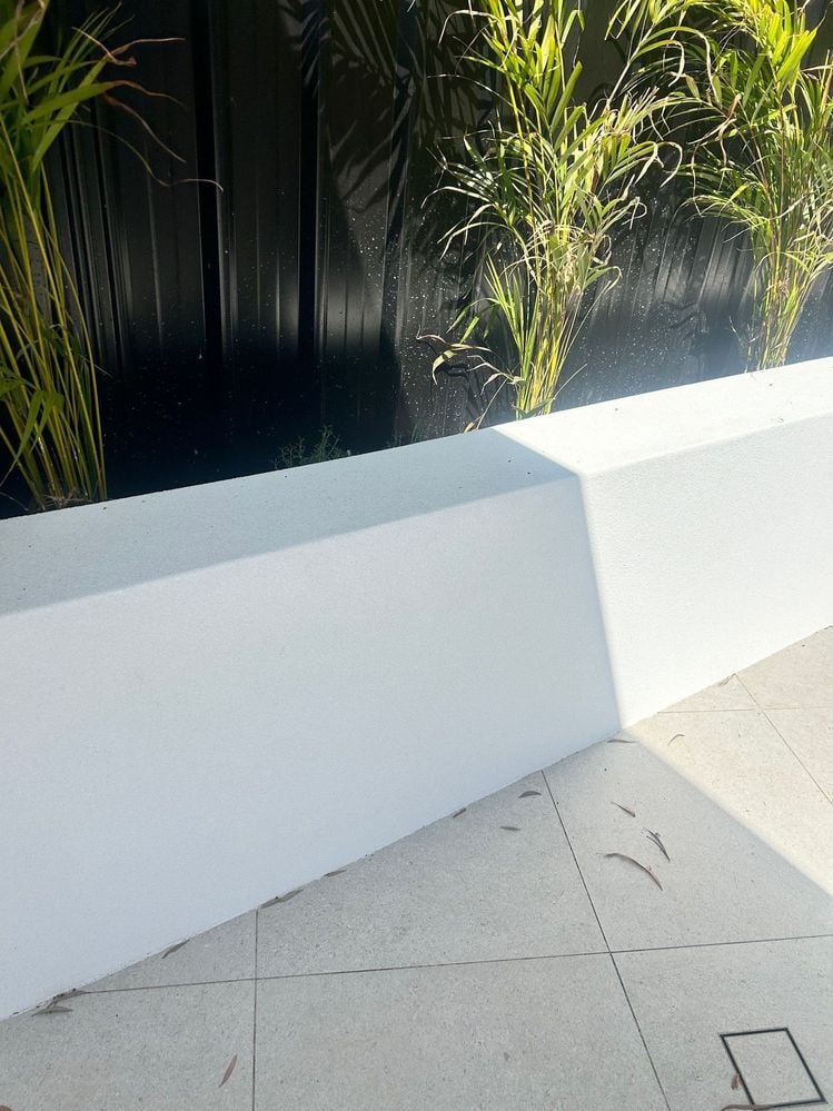

I created a garden bed out my back and i have planted golden cane palms but they are going brown and i think due to lack of drainage they are drowning. Ideally i dont want to have to dig everything back out but can anyone suggest what's the best way to get drainage in here?
as you can see from the images one wall is the rendered wall and the other is a brick wall up to protect the fence

Unfortunately, I don't see a way of adding drainage to your garden beds that isn't fairly involved. The only way I see it being possible is to temporarily remove the plants and place them in pots, then install some Reln 65mm x 7m Slotted And Socked Stretch Ag-Pipe along the base of the planter that discharges outside of the planter box. Ideally, you would also add a layer of drainage gravel at the base of the garden bed that is around 50mm thick, however, this would require you to remove all of the soil.
You would then need to drill a core hole through the end of the garden bed where I have circled below to allow the agi pipe to discharge out the side of the planter box.
This would require some fairly expensive equipment including a Full Boar 2000W 150mm Core Drill and a Full Boar Ø77mm Diamond Core Drill Bit, so it is likely worth contacting a company that specialises in concrete cutting and coring for their assistance.

They only thing I can think of is that end that @JacobZ has circled is to remove that and then dig out your garden, before replacing the soil put some socked ag pipe in the base with some course gravel around it. With the outlet into the arden bed next to the circle. Pretty much what JacobZ has siad bar teh core drill This I would think of as a long term solution.

Really really helpful. What if i, entertain me here for being lazy ha, removed the colorbond fence at the back and drilled some holes into the side of the brick against the fence, would that work?

commonly known as Weep Holes.... yes that would help. Didn't realise that removing the fence was an option, but since it is, give that a go as a simple solution.

Similar to @TedBear I hadn't considered removing the fence panel as an option. It would certainly work and sounds like a good option.
My only suggestion is to add some corflute on the fence panels to protect them from being constantly wet which could cause issues down the line.
You could attach the corflute to the fence panels with Liquid Nails before reattaching them to the posts.

I dont see an issue with removing the fence panel and drilling some weep holes either, I would suggest that there be a 10mm gap if possible between the metal of the fence and teh brickwork so the water isnt resting against the metal all the time.
