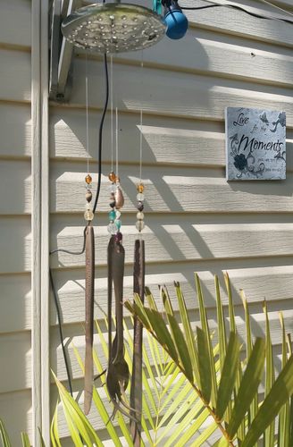

I'd like to know if Bunnings drill holes in SS cutlery as I don't have a drill press any more. I've made lots of windchimes with cutlery and want to make some more. I have an electric Ryobi drill but no clamps but could borrow these.
What drill bit would work. I did break a few last time I made the holes using a drill press which I gave away. Can anyone help me in store or recommend where I can get help to drill a hole in the end of each fork knife and spoon about 12 pieces? Thanks.

Sorry I didn't see this (did the OP construction change - there was no photo?)
