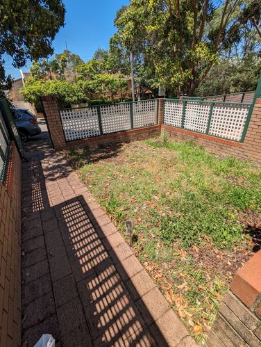

I have a small patch of garden at the front of my townhouse that is in desperate need of a refresh. I'd like to dig up the existing soil/weeds and add some new soil and turf. There is a stormwater drain in the corner (see photos) and the garden is sloped down to the drain (it's around 3-4 bricks below the higher section).

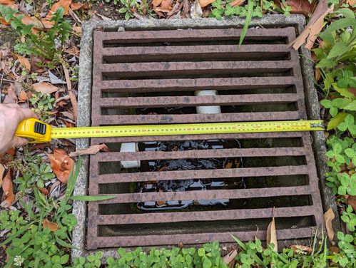

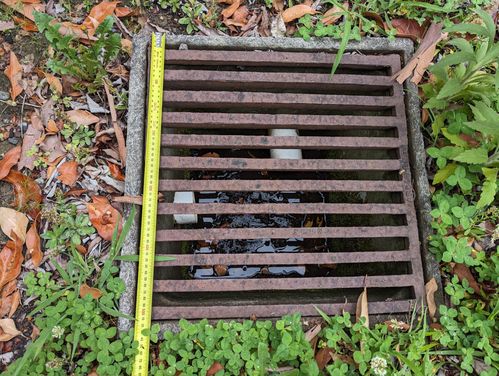

Is there a way to raise the drain without major structural changes? The drain cover is around 500x500mm (see exact measurements in the photos).

I'd suggest that you enlist the services of a drainage expert to advise on the possibility of raising the drain. Your yard is suspiciously sloped down to that point, and I highly suspect that it was designed this way to funnel water to the drain. By raising the soil, you run the risk of the area flooding as the water can't drain to the lower point.
It could just be as easy as having a stormwater pit riser installed, but I believe it's important to assess the whole area to ensure you're not risking a major flooding event.

I thought I'd also add that there might be an added complication with your plan to level the area - that the brick wall is not designed to bear a load. You would likely need to build a retaining wall in front of it or replace it.

further to what Mitchell and Jason already said, I would wait for the next big downpour and then head out to take photos of where the water is going. I did that once in our garden before committing to a major drainage project, and this advice has proven to be very helpful. You will then have much more "data" to make a good decision.

Does anyone have any alternative ideas for a yard refresh? Ideally I'd like it to include a patch of grass (even if it's sloped down to the drain), but I'm open to all ideas. More current photos in this post.
