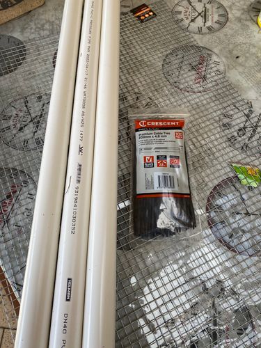

Materials for the project
40mm PVC Pipe
Wire Mesh 600 x 900mm - hole 12.7mm
Cable Ties 200mm
Wheat and Barley Seed from the Stockfeeders
No tools required, easy as
Steps
1234
Step 1
1/4

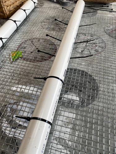

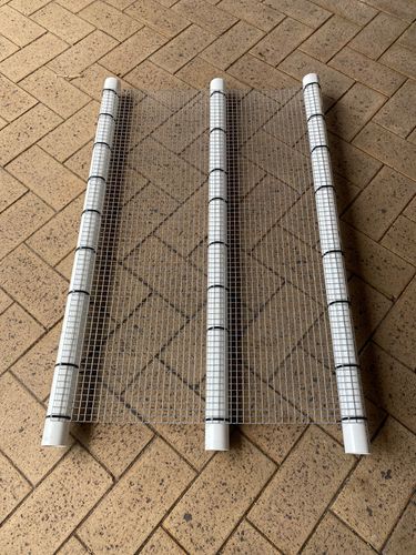

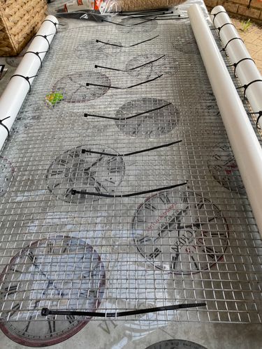

Simply cable tie each piece of pipe to the mesh. I found it easier threading the cable ties on first and then securing them nice and tight. Yes you will need a piece in the middle as the girls can be a bit heavy 😆 😆 I’m happy with the height of it, it is tall enough for the grass to grow through it. You could make it to the size you want.
I didn’t want to use treated timber because of the chemicals and I didn’t want to use untreated timber that would swell when wet, so the PVC is perfect.

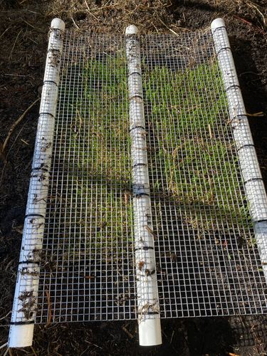

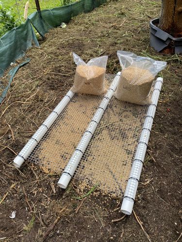

Ready to place into the Chook Run. Straight onto the ground. I got a couple of bags from the Stockfeeders - Wheat and Barley.
Liberally add the seed. I didn’t even bother to cover with soil, need to, if you want to just cover very lightly.
It’s important to keep the seeds moist, so hand watering every day.

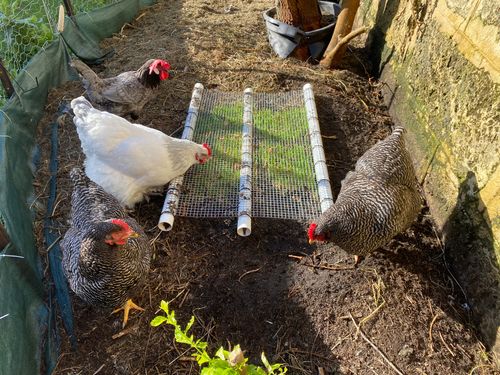

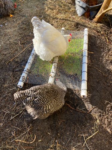

And Day 6 the wheat and barley seeds are germinating nicely and the girls can eat it, pecking away the tips of the grass. Now it really becomes a Boredom Buster  !!!!!!
Previous StepNext Step
Step 4
4/4
And there you have a Grazing Tray for your girls 🐓🐓🐓🐓
Once it’s done, I will move around the Run. Just remember that the holes need to be small enough that they can’t eat all the seed and they are happy to walk on.
