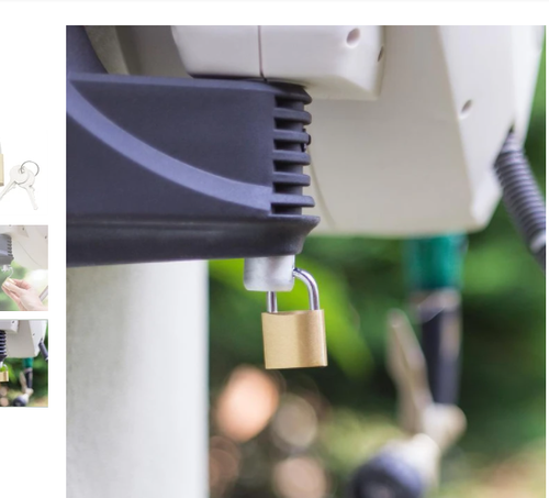

Hi @GardenJunior , Great idea from @EricL, if you don't want to drill the plastic , you could place the padlock on the pivoting pin, the pin shown in the picture is alloy, it should be strong enough to reduce temptation to use the hose. You might need to change the tap handle to one where you have to insert a key to turn it on. See image below.
https://www.hoselink.com.au/products/padlock
