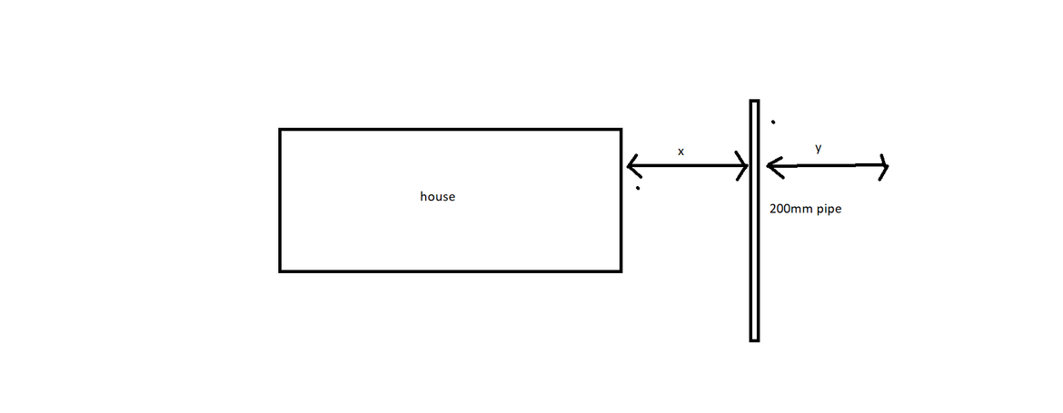

How does a drainage pipe collect surface water ?
Thanks. The post probably more a noob drainage question : how does laying a 200mm pipe can collect all the surface rainwater ? eg. in the picture how does surface water from either side of the pipe, x & y, go into the pipe instead of straight down, if not the yard still soggy ?drain pipe.png

When water gathers on the surface of the soil it will sink down into the area of least resistance. This would be the gravel surface, and as water passes through it will reach the slotted pipe. The water in the pipe now gets directed towards the exit. It's important to remember that the channel that you dig for the drain coil will have a fall.
A fall can also be defined as a slope that has been applied to the channel that has been dug in the soil. Which is why the water flows down a draincoil.

as @EricL and @Jason have already pointed out, drainage is all about fall. A French drain uses gravity to collect water in a depression, but in our urban areas we usually don't have enough space for this. Hence we need to use additional structures to direct surface water into drains.
A very common such structure are retaining walls where you'd bury the drain at the foot of the wall and connect it to your stormwater drain system. There's no need for this wall to be tall, some solutions are just one step high.
It would be helpful to know how your ground falls in your drawing. Does it generally fall right-to-left or left-to-right? Or is your drain already located in a depression?
