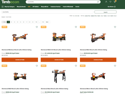

HI @BigFella1956 , Not sure if you have heard of Timbecon, they sell wood lathes plus all tools required for wood turning, they will assist you in selecting the right equipment for your needs. They are located in Melbourne and Perth, they deliver all over Australia.
