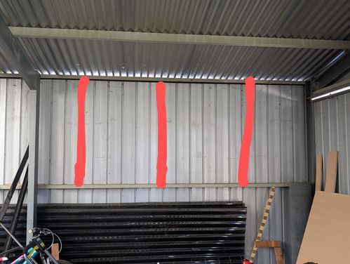

Thanks All! Is this what were meaning by installing a timber frame? Being a 2m pegboard, we could probably add a 4th vertical support if needed.
Our shed does get a bit on condensation through colder months, would treated pine we best suited as it isn't weather-proof/ insulated?
Re: How to install a pegboard on steel shed wall?
That's what we meant @ksize. Just ensure you position the uprights in line with the mounting holes on the pegboard.
It sounds like using treated pine would be a good option.
