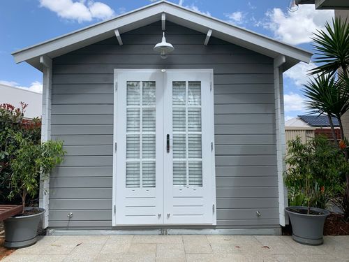

That's a glorious shed, @Juliaz, well done! Those weatherboards look beautiful, and your shed is a great blend of style and function. I won't be surprised if it makes it to our list of Top 10 most popular garage and shed projects one day.
I'm sure our members would be keen to know details of your process. How did you go about building this shed, and what were the tools and materials used?

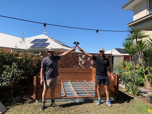

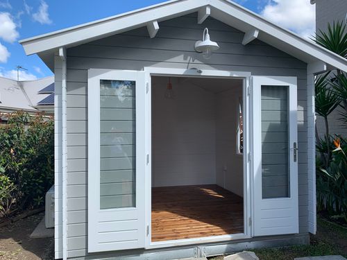

Thank you! First step, my husband Chris decided to use a Galvanised subframe for the shed. Chris ordered standard 3m lengths which he cut down himself to achieve the nine-post design he wanted. The frame was set on posts that were concreted into the ground. All screwed together with 12 x 20mm Tek screws and a cordless drill all purchased from Bunnings. The hardest parts of the build for us were the preparation of the site and digging the holes etc. We also needed a trench to connect the electrical/data/internet from the main house which delayed us. The actual studio (kit) itself was very straightforward when following the instruction folder that came with the kit. There were many unplanned trips to Bunnings for various reasons including unforeseen things that would crop up or having the wrong tools for cuts, drilling ect, Chris purchased hex galvanised screws Dewalt cordless drill and Ryobi multi tool and a Ozito angle grinder just for that job. Chris appreciated the fact that Bunnings has many close locations and opening hours are very convenient.
