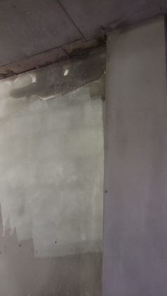

Our full brick 2 storey house has northerly aspect with driveway & garage occupying the NE corner of the block. I have water seeping though the garage's concrete top along the eastern wall as seen in these photos.
001c7b17-7804-4822-8137-1683b7e63a41.jpg  Middle Middle Back wall Back wall
The photos below suggest that there are obvious entry points for seeping from water pooling at the top of the garage and from garage window's sill.

I'm afraid the leak happening to your wall is quite severe and no amount of sealer will prevent the water from coming through. I suggest engaging the services of a registered builder and have the leak from your windowsill and possibly the roof repaired first.
Sealing the wall with product at this point will be just a waste of material as the water will simply push any paint or sealer off with hydrostatic pressure. If left unrepaired the water start to eat into your brick wall and compromise its integrity.
Once the leak is repaired you should start to see your wall dry off, and that dark hue will start to fade going back to its original concrete grey. This would be an excellent indicator that the water is no longer flowing into your wall and then you can make plans to paint it.

Most of the water penetration is likely through the roof @Farid. Waterproofing the entire surface would probably help. The flashing on the right in the fourth image has pulled away from the wall and needs to be adhered back to it; Sikaflex 11FC could be used for this. At the moment, water would be running down the wall and behind the flashing, entering the area of the wall below. Once the roof is waterproofed and the flashing repaired, you'll need to speak with a drainage expert about how to route the roof's overflow to a more appropriate location than directly onto the window beneath. The downpipe right next to it would be a good option.
You could attempt to resolve these issues yourself, but I advise you to have a professional examine them first to get an idea of what needs to be done.
