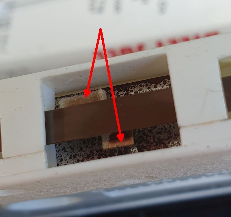

It still works, but I noticed that small pad displaced from its copper mount.
Is this crucial to the workings of a cassette? I have no idea.
If so, what glue would you recommend - or none?
It's 41 years old and full of nostalgia. 😁
I would like to keep it a little longer if possible.

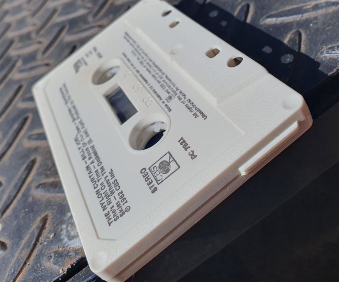

His 'The Nylon Curtain' album.

I suggest visiting your local salvos and purchasing a 1-dollar cassette, sometimes they are even cheaper. Take the cassettes apart and get the working "pad assembly" from the donor cassette into your Billy Joel cassette. This will save you from having to expose your tape to any strong adhesives. Once re-assembled I suggest popping the tape into the deck and see if it works.

I like @EricL 's solution as it would get it back to being as close to original as you can. I can remember pulling them apart when I was younger.
I am pretty sure those pads are there to give pressure for the tape to run over the heads of the tape deck (potentially not needed). If that pad is "loose" Id remove it, otherwise I would try and sorce/or record to your pc/laptop to have a copy first so if it breaks/perishes you will still have the album ![]()

The crazy thing is with all the handling of the cassette, I lost that felt pad. 😉
I had no luck with the Vinnies idea above - but then I realised - can the copyrighted cassettes of yesteryear actually be disassembled?
No screws. To me it looks like you would need to 'crack' the plastic joins?

Now you have nme questioning my memory! lol I remember taking the spools out and putting them in other cases quiet strongly. I think I ran a knife and then levered it until I either snapped the plastic clips inside or jimmied it open enough that brute force strength kicked in

Hello @Noyade replacement felt pads can be purchased online but why not use an appropriately sized piece of adhesive door seal insulation? So long as the surface (copper strip) is prepared sufficiently well you should be good to go 👍
