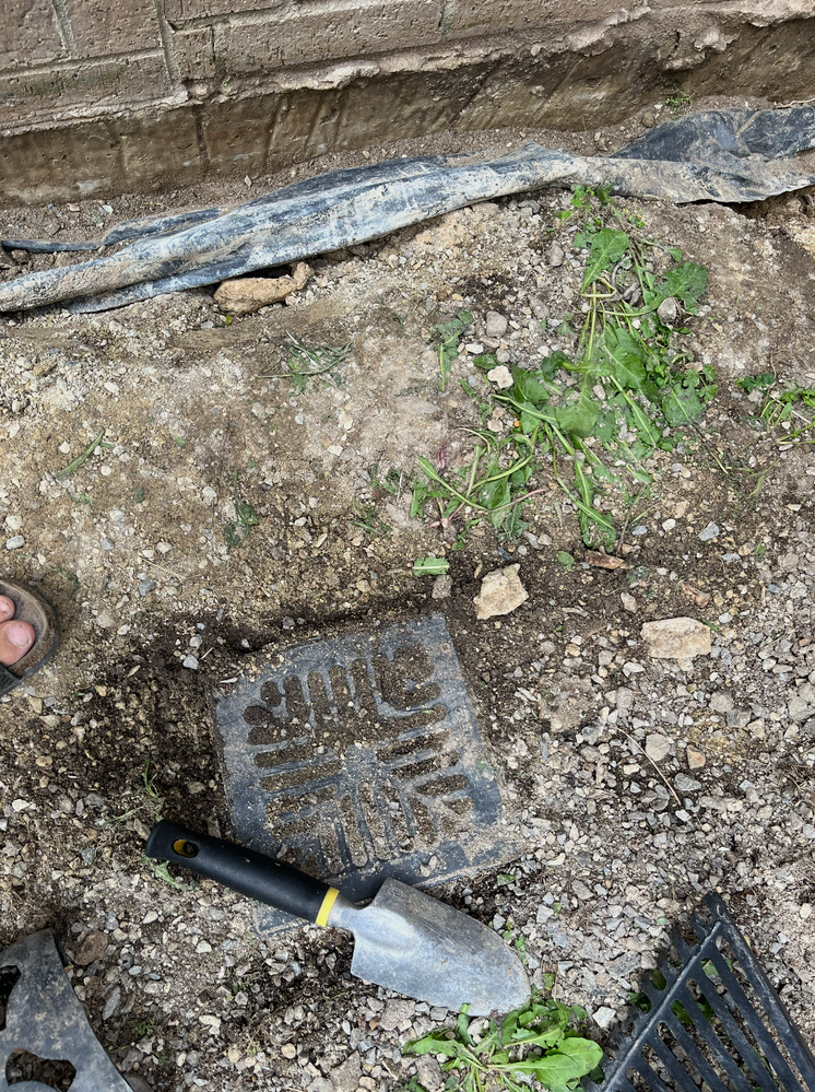

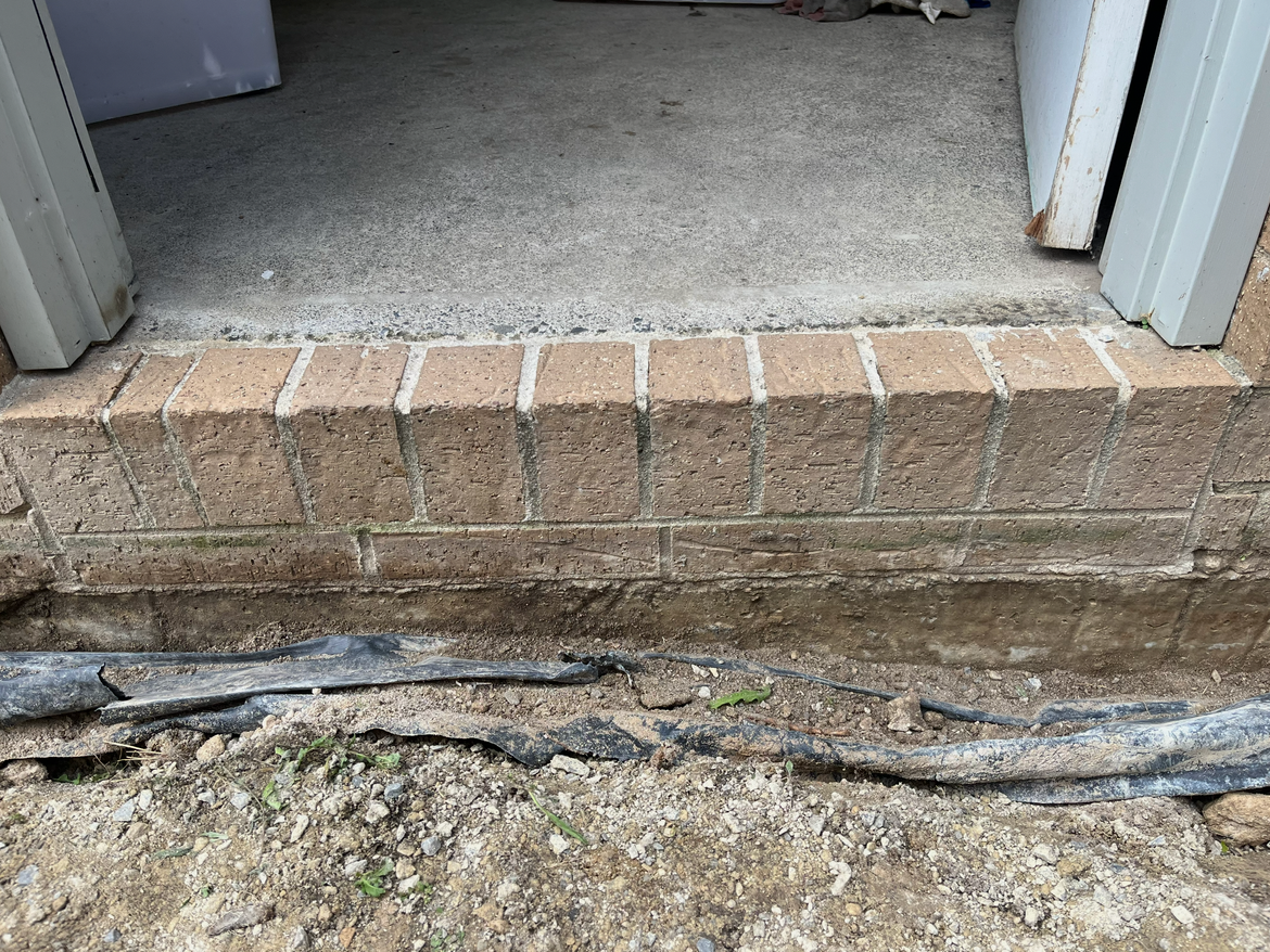

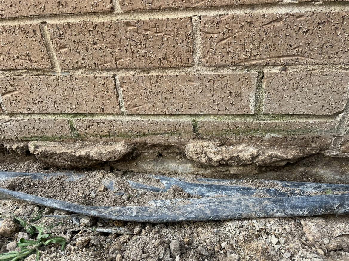

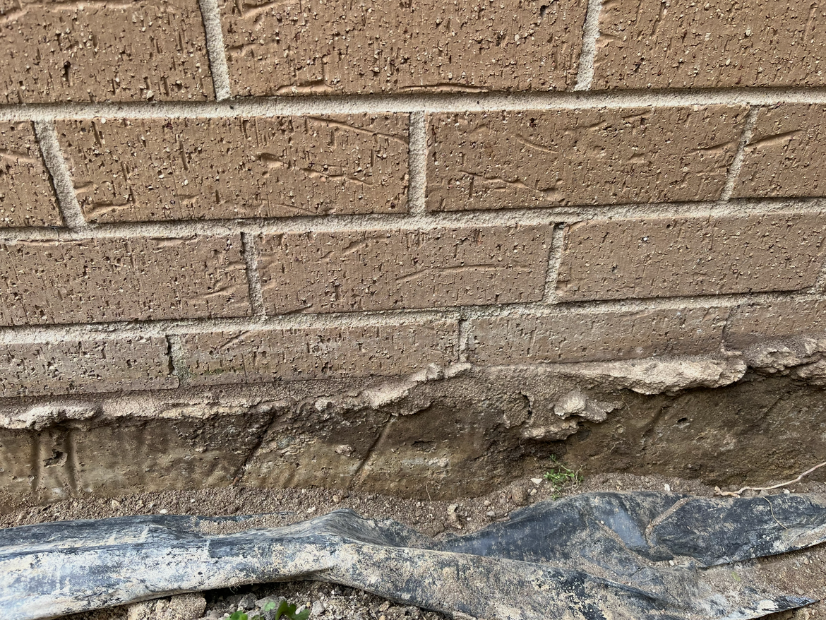

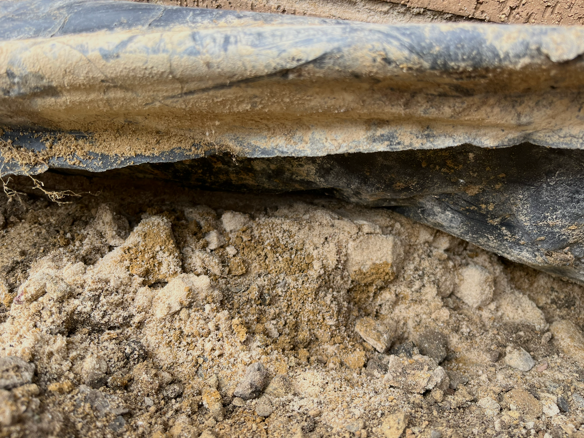

Hi Mitchell,
I finally got around to removing the soil and gravel from the outer edge.
There seemed to ve a mixture of dense clay, sand, gravel, plastic sheets and odd bits and pieces (our town house it sitting on the grounds of the old Kodak Factory)
I'm curious to know where you would suggest I go from here. It looks like there was a rim of brick on the bottom that has crumbled away over time. Does this need replacing? also, I wonder if its worth cleaning all the brick with a high pressure spray gun before drying it out and then applying the brick sealer?
