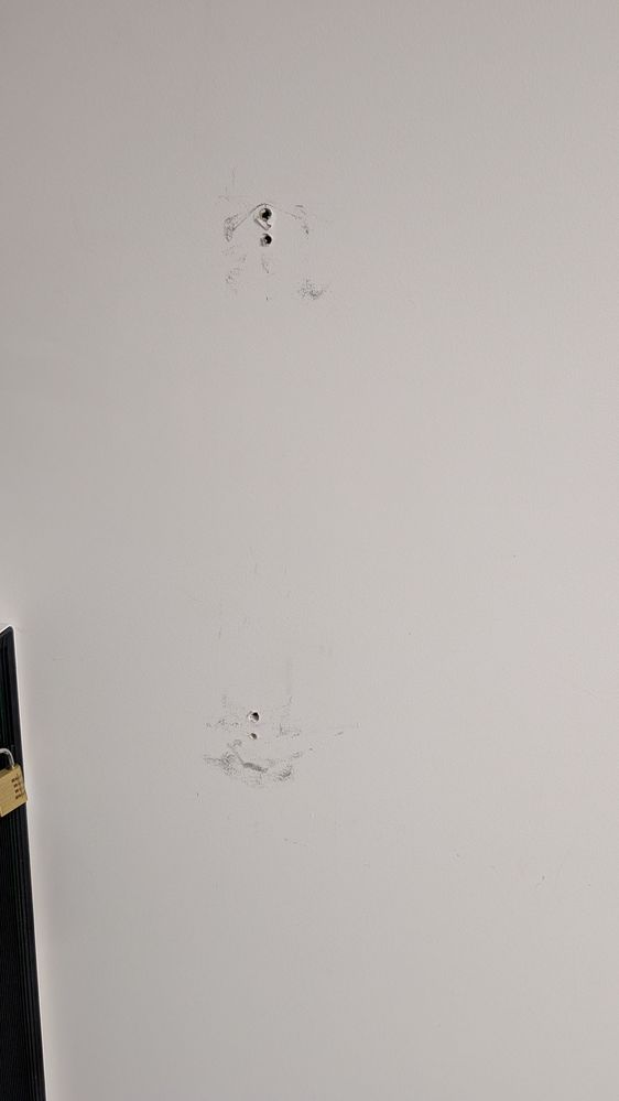

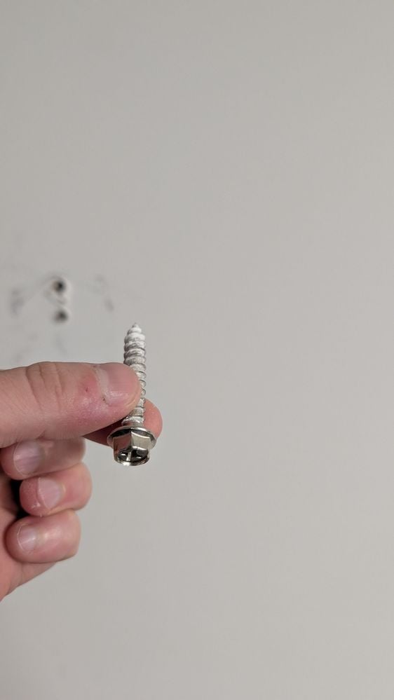

In my garage I have plasterboard which seems very flakey. I've managed to put some things up with wallmates and they seem ok, especially inside the house. However, I tried to mount a holding mount for Steadyrack bmx bike. The screwn seemed to go in fine but when I put the bike on it the screw just came out of the wall, nothing really for it to screw into or hold (no stud). The wallmate also came fully out, as in just punctured a hole through the wall, nothing to hold onto.

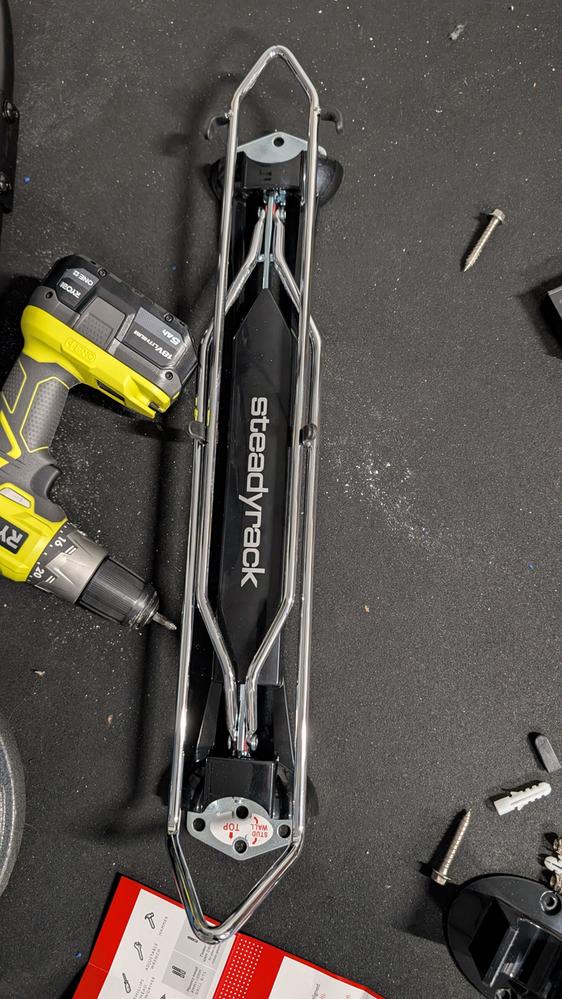

There is no beam behind the wall for me to mount the steadyrtack, is there any specific bolt or screw assist which I can get from bunnings noting my issue?
The mount rack will hold 1 adult bmx bike and I have another steadyrack which which hold a kids bmx bike.
I assume I just seal over the wholes and then when they are good I can re-use the same spots? Pending having something that will actually hold and not just make a hole in the wall.

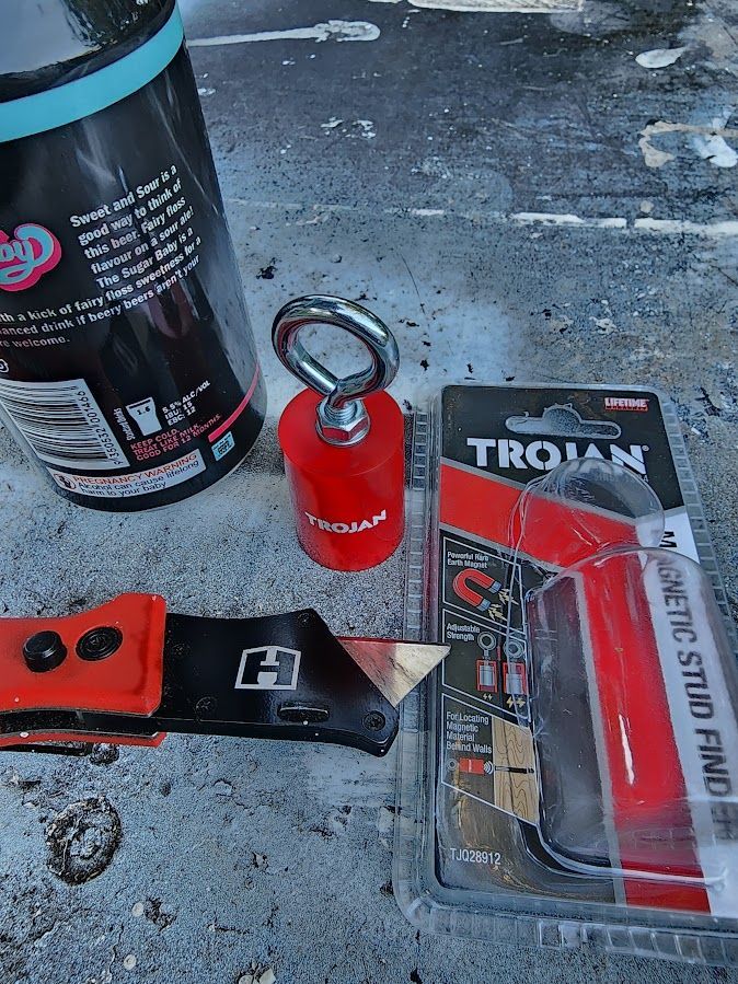

I wholeheartedly recommend rare earth magnets to detect stud screws and nails @andyroo25 - once detected use your spirit level to 'draw' the vertical line.
And the price mentioned in Jacob's link is a 'special' price until the 24th of this month - normally around $20. Currently $14.80c
https://www.bunnings.com.au/trojan-magnetic-stud-finder_p0673723
Bargain!

(I note the magnet is now back to $19.98).
