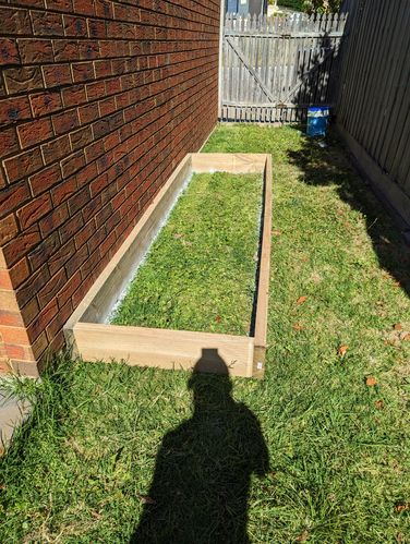

Check the specifications on the garden shed to get correct measurements for the base and build the frame. The Instructions will tell you the size of the concrete base. Place the frame where you want it to be and mark it, I used a spray paint I already had.

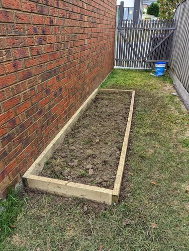

Dig the area so you can bury the frame enough to make it level. I didn't go for perfect level I thought it might be good to have a slight angle. But not too much to a point where you feel it when you walk on it.

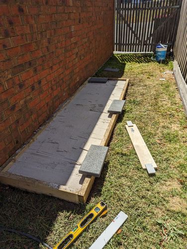

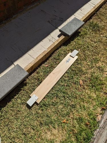

I made a quick jig to level the sand before laying the pavers. Just used 3 pieces of wood I had. Get a piece of wood, wide enough to fit within the frame, measure the height of the paver and attach 2 guides to the end of the piece of wood to so it stays level with the frame. Use this to make sure you get the sand up to the correct height. Don't have exact pics on how I used it, but hopefully easy enough to understand.

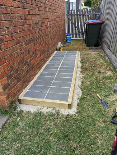

Once the sand is filled to the correct height, you can lay the pavers and fill the gaps with sand. You might have to cut/break few pavers to fill the space. I just used a chisel I had to roughly mark the line and slowly hammered my way around it. Took me 30secs to break the paver.

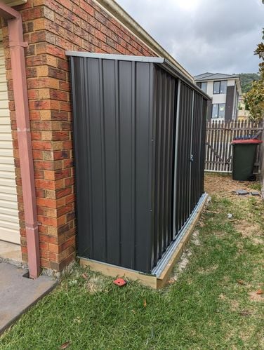

Now build the garden shed by following the guide and video, place it on top of the base and attach it. I was able to attach it directly to the wood frame.

I am yet to fill the gap between the wall and shed as I don't want this to be the perfect place for all the bugs in the world to live. Planning on filling the edge of the gap with some foam and maybe caulking.
Might give the frame a paint so it looks a bit better.
Not related but build a taller new gate so the shed it not too visible from the driveway.

As you might notice my frame has a slight bow to it, which meant the pavers didn't line up well. This is because the wood already had a slight bow, and I filled the inside of the frame before filling the outside, this meant the more I filled and compressed the sand, the bow got worse, so I would make sure outside is solid and has proper support before filling the inside.
